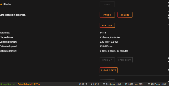

so is there a way to force parity sync  like a clean setup of parity to avoid the above pic its doing data rebuild
so when what i did with that parity problem tool  i selected  Yes  and then Check...  and the hard drives were all lite  up.. and the GUI  was unresponsive
and then i got a 500 error.. on the screen... about 5 min after clicking the Check    the hard drives all stopped flickering and the Gui was working again and and no data sync or something i forget what it said at bottom
and i dunno if the logs show anything in the diagnostics above as i cant remember if i did a reboot in between running that check  so not sure
now
and i dunno why its doing data rebuild  or why its going to take 8 days..   is there anyway to for a party sync after i formated disk 1   and reset party and get it back up to the 200mbs speeds  all drives are 7200 and they worked before the ram issues   i getting the new ECC ram today so i hoping that solves issues  but i cant get the drives to go faster

and i cant get data rebuild off  and partiy sync on..  or  speed up drives to 200mbs  from 14mbs   8 days for a partiy sync/data rebuild frig     so i think the parity sync errors are still corrupt from what jorgeb was saying

or is there a command line to format parity drive  to start a resync  and increase disk speed..  and is there someting that is slowing the parity rebuild  to 14mbs   does logs say anything       can  i do a new build  and remove the parity drive   and run the disks indivdually    and then add a partiy drive.. what options are there

least thats what i was thinking or if i could format  parity  drive  or add a 2nd parity drive i dunno  but i dont want it to take 8 days thats all i know  and i dunno why its sooo bloody slow

and do you guys know why the datarebuild is going so slow?
