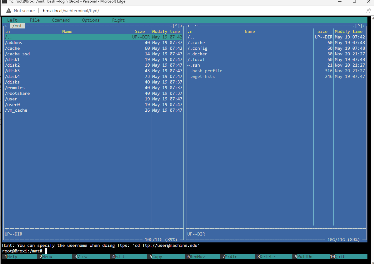

fix common problems reports this "Invalid folder cache contained within /mnt" had a look at my shares and they all point to cache_ ssd or vm_cache  so where to look now
think its plex as its appeared in /mnt/cache/appdata and also in /mnt/cache_ssd where it was supposed to be,and plex lost all libraries after this, any help please

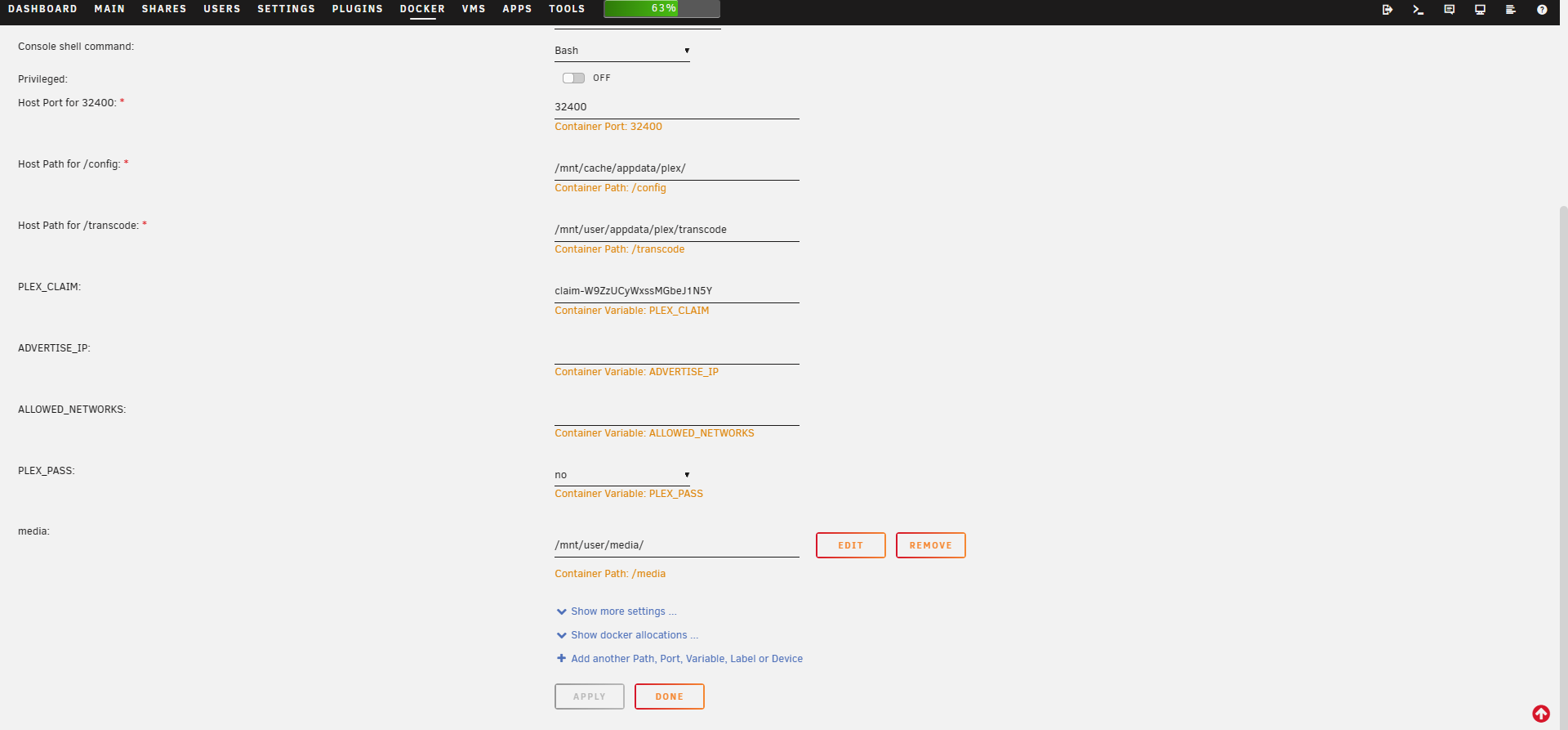

The host path for the plex /config folder in your screenshot shows it is pointing to the wrong location.
Thanks plex also lost its libraries at this time so decided to uninstall and delete everything relating to plex, clean install and rescanned with fix common problems and all clear now and all plex files in the appdata in cache_ssd.
