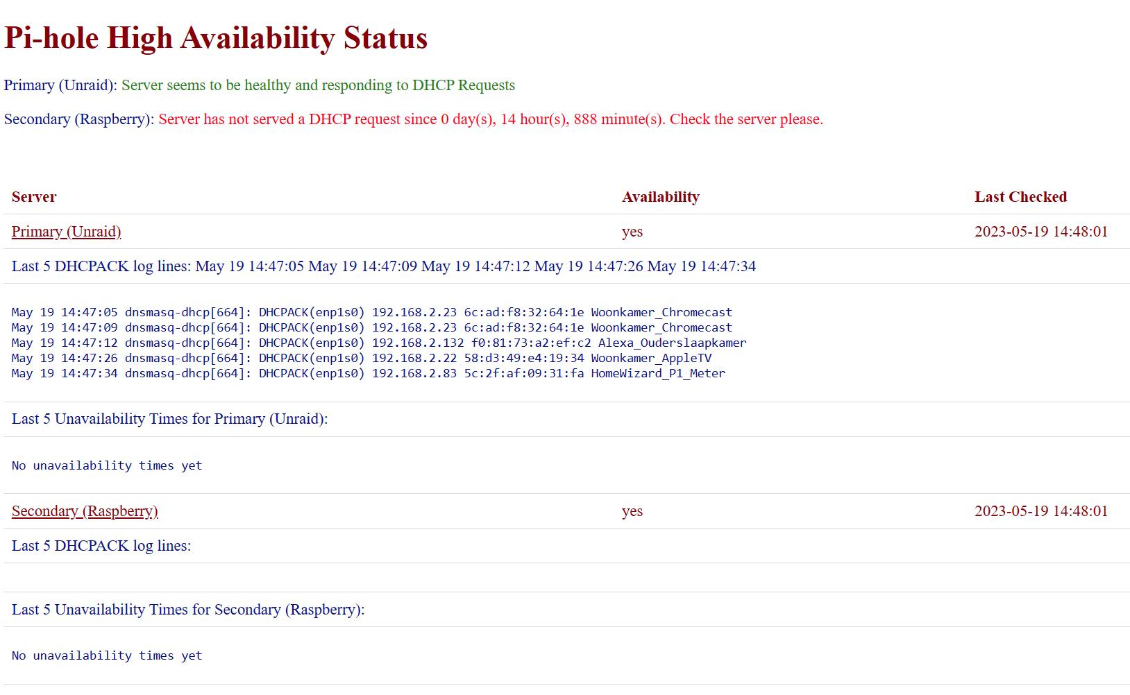

Make sure to change the variables in the beginning to fit your environment. Create a (free) pushover account and you will receive push notifications if the primary server goes offline.
The way the system checks if a DHCP server is functioning is looking at the logfiles, and looking at the latest line that shows a DHCP package has been delivered, this should be no longer then 60 minutes ago and you need to allign that with your number of devices and your DHCP lease time. Those are all variables.
To give as much troubleshooting info as possible the script also does a ping test to see if the server is reachable at all.
The primary and secundary headers in the html are clickable and bring you to the specific PiHole server.
You need to schedule the script in CRON (or with userscripts plugin) to make it run as often as you want, I am running it every three minutes.
