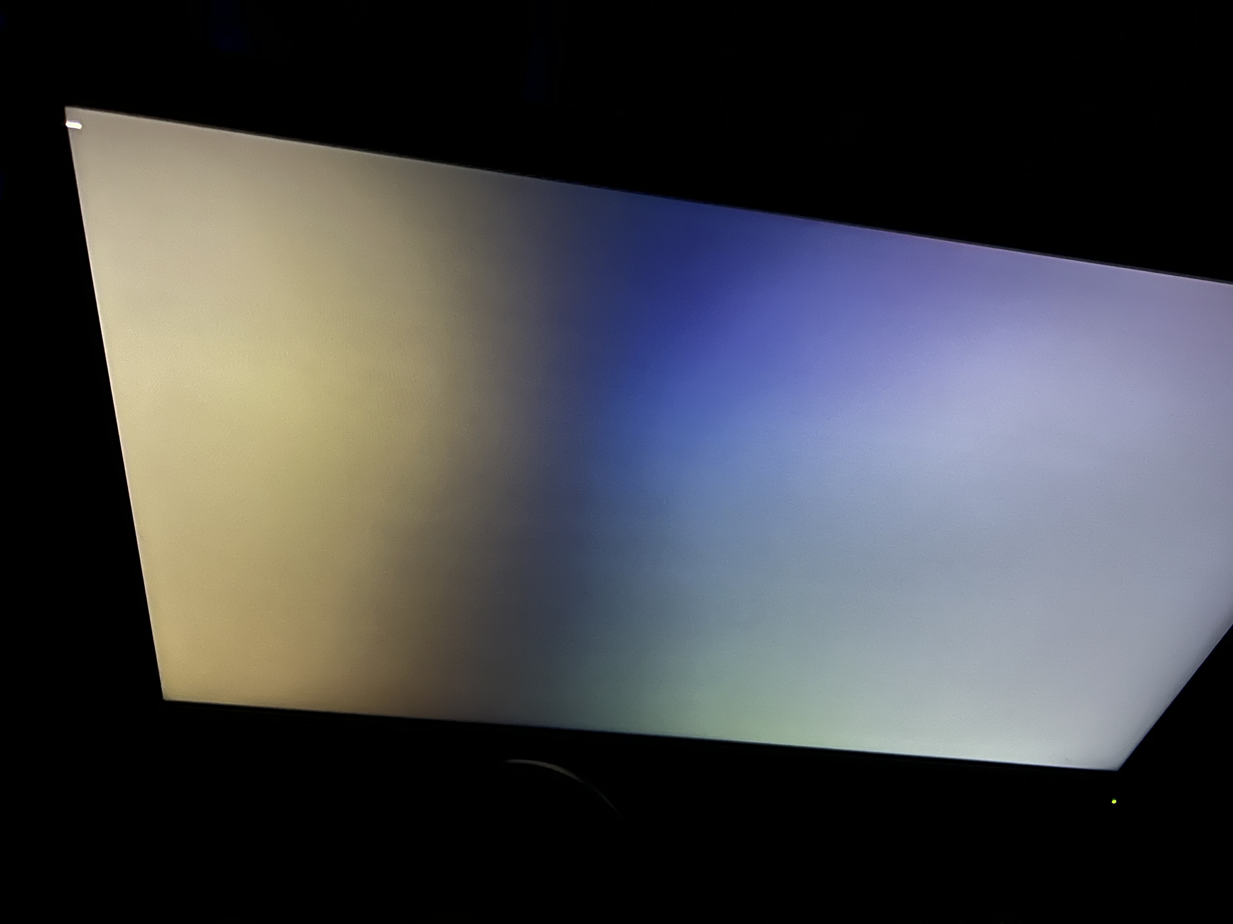

Hello all,
Im having issues getting my Unraid GUI to load; The screen remains blank the cursor just blinks.
Note: The console mode appears to work fine.

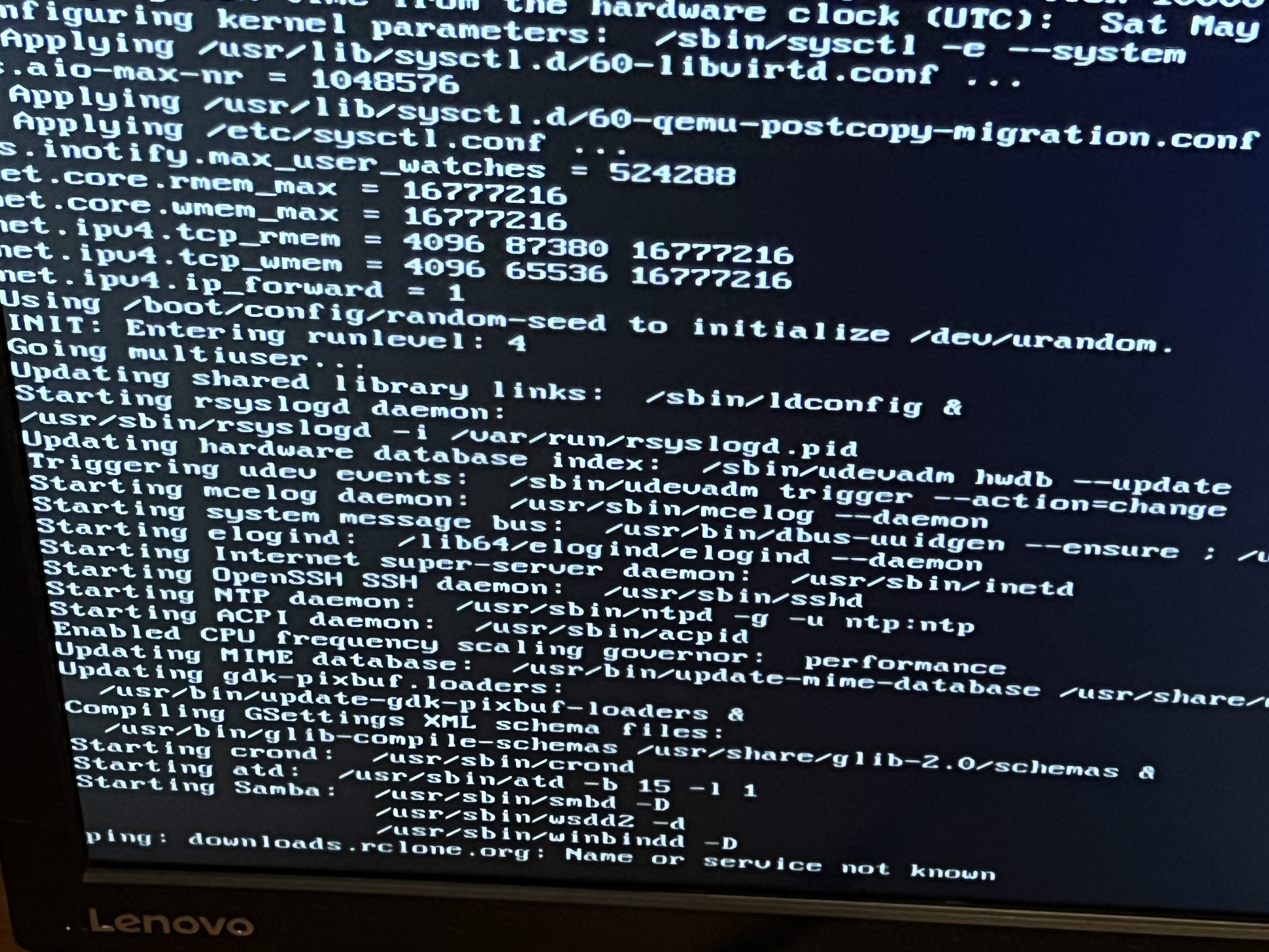

My suspicion is that there is an issue with rclone.org which is causing this issue to occur as I get this error in the startup phase:
”ping: downloads.recline.org: Name or service not known”
