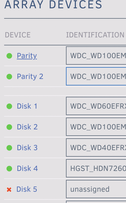

I currently have a failed drive (6TB) in my Disk5 slot (red ball icon). My 2 parity drives are 10TB.
I shutdown my server, and I have removed the failed drive (6TB) and put in a new 18TB drive.
I am preclearing my 18TB drive now. Array is currently stopped. Disk5 slot is now unassigned. I hope so far this is correct move by me.. please do correct me if I am wrong.

May I check, do I do the assignment both at once? My current state is Parity2 (10TB) still assigned, Disk5 empty (previously 6TB failed). 18TB (unassigned) being precleared (and assume it will be cleared for use).
Meaning do I now, (1) Unassign Parity2 slot (10TB drive), (2) Assign that 10TB parity2 drive into Disk5 slot, (3) Assign 18TB into Parity2 slot, (4) Copy Disk5 (parity2 contents) into Parity2 (empty 18TB), (5) start array to rebuilt Disk5 (overriding its parity2 contents)?

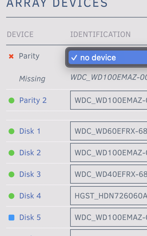

I got around to doing this today, and for some reason Parity 1 slot is not showing the new drive, but Parity 2 slot is able to show/select it. I want to use the bigger HDD for Parity 1 instead. Is this not possible?
Current:
Edit: after moving the drives around the new drive is somehow appearing under Parity 1 to be selectable. Not sure if this was a bug in 6.9.2.
Edit2: After selecting the new drive in Parity 1 slot, it does not show up at all! Is the wiki instructions outdated?1305081895_CleanShot2023-06-02at06_45.17@2x.thumb.png.41ce88e622555b94b32196789a1f65e9.png

I have attached as requested, hope you can advise on next steps.. What happened was Disk5 errored out, had to preclear new drive so unassigned Disk5 and started array to run Preclear on new disk. Now that its done, array has been stopped.
tower-diagnostics-20230602-1746.zip
Disk itself looks OK but it's generating this error:
Jun  2 06:38:09 Tower kernel: md: import disk0: lock_bdev error: -13
which I don't remember seeing before, try swapping that disk with one using the onboard SATA controller to rule out some compatibility issue with the HBA.

Thanks! I switch it and it seems to be working fine as expected. Copied without errors over the past day and rebuilding disk5 now.

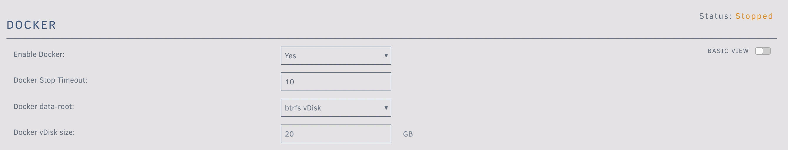

Also, just to check, is it normal that Docker and VM is turned off when doing this parity swap and data rebuilding?
Docker: Docker Service failed to start.
VMs: Libvirt Service failed to start.
Anything we should know about other services being turned off as well?

I am confused about your response because I didn't turn it off. This is my settings:
1282288101_CleanShot2023-06-04at15_33.00@2x.thumb.png.60fbd839e905e20dd2098ea5f8e29cfb.png
So any idea why it is stopped? Is it because of the parityswap/data rebuild going on?

Have attached as requested (it was after data rebuild). Data rebuild was completed 2 hours ago and I still don’t see Docker and VM up.. so something must be wrong.. thanks a lot for helping to look into it!
tower-diagnostics-20230605-1612.zip
I don't see any attempt to start the docker service, try disabling the service apply, re-enable, apply and post new diags.

I restarted and that seemed to do the trick! Attached new diags just in case.tower-diagnostics-20230605-2330.zip
