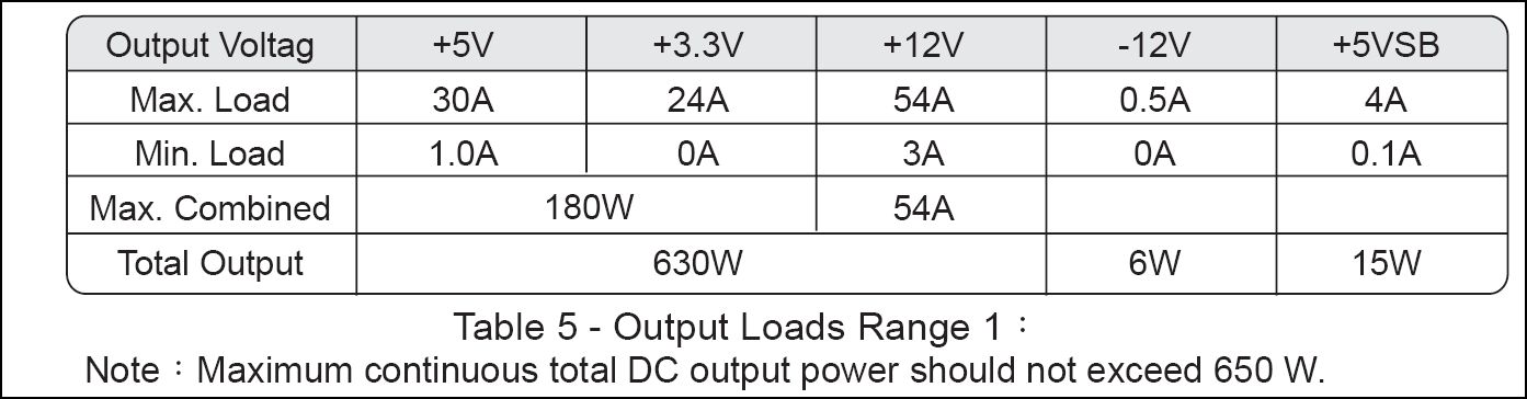

You almost have it, but even a single rail power supply rated at 650 watts will not be able to deliver 650 watts to the 12 volt rail.  Those watts also include the 5 volt and 3.3 volt supplies.
As an example, the CORSAIR CMPSU 650TX has these specs:
+3.3V@24A, +5V@30A, +12V@52A, [email protected], [email protected]
3.3 volts * 24 Amps = 79.2 Watts
5.0 volts * 30 Amps = 150 Watts
12 volts * 52 Amps = 624 Watts
-12 Volts * .8 Amps = 9.6 Watts
5 Volts * 3 Amps =  15 Watts
These add up to more than 650 Watts.   If you read the manual for that supply, it states that you cannot exceed 650 watts total from all the supply rails.
It also shows that the 3.3 volt supply and 5 volt supply have a max combined wattage of 170 watts.  It the load on the 5Volt and 3.3 Volt supplies is low, you might be able to use most of the 624 watts potentially available on the 12 volt rail.
Most single rail supplies have this same limitation.   Even though the 12 volt rail might have the capacity, the total wattage available must be shared by the load on the 5 volt and 3.3 volt rails.   Most disk drives will draw about an amp on the 5 volt supply.  For your 10 drives, that is 50 watts of the total capacity of the power supply not available for 12 volt rail.  You can probably add another 50 or more watts used by the motherboard.  All of a sudden 100 watts of your 650 watt total is in use.  Now, you can possibly draw 550 watts from the 12 volt rail.  That would be 45 Amps.  (sized for roughly 15 to 18 drives, maybe 20 if they were all "green" drives... remember, you still need to power case fans)  Now you can see how the "marketing department" makes the supply seem higher capacity that it might actually be able to handle.
You can see that in the attached table from another PSU marketed as a single rail 650 watt supply.
Joe L.

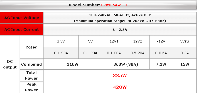

I did more research, I actually have the 385W Enermax Pro82+. it has 2 rails rated at up to 20A each, but combined to 30A... So i guess 30A is my limit.
I imagine I will be able to identify each rail based on the wires coming out of the PS.
Ah, ok thanks.
If I'm reading the manual for that supply correctly, it appears as if :
12V1 powers the 24P motherboard connector and the 4+4P CPU connectors.
12V2 powers the 1x 6P PCI-E, all 5x SATA, all 4x 4P Molex connectors, and the 1x FDD connector.
Your total capacity for disks and case fans is therefore at best 20 Amps (peak)   Your limit is 20 Amps... not 30. (assuming the motherboard and CPU do not use more than 10 Amps)  Even though the 12V1 supply may have  additional unused capacity, you cannot access it as it is only used the the motherboard and CPU connectors.

This PSU should be more then enough for your current system, and provides a bit of headroom to expand a few more Green drives (maybe total of 15 green drives max...).
It seems to be getting confusing with multi rail power supplies.
I think that is on purpose with many power supply manufacturers and their marketing and sales departments.
It is often very difficult to determine how the rails are wired.  Some manufacturers do not supply the information at all.
They want you to focus on the total wattage number, the bigger the better, even if not useful for your application.
But the manual that you linked previously for Enermax 82+ states it supports 11 hard drives for the 385W version and a quad core and a single video card (which the OP does not have) as he is limited to max 10 hard drives anyway with his current hardware (mini ITX MB with two onboard SATA ports and a PCI controller for 8 drives)
And that same manual also says:
* Actual maximum support might vary by power consumption of connected components and is limited to DC output specifications.
