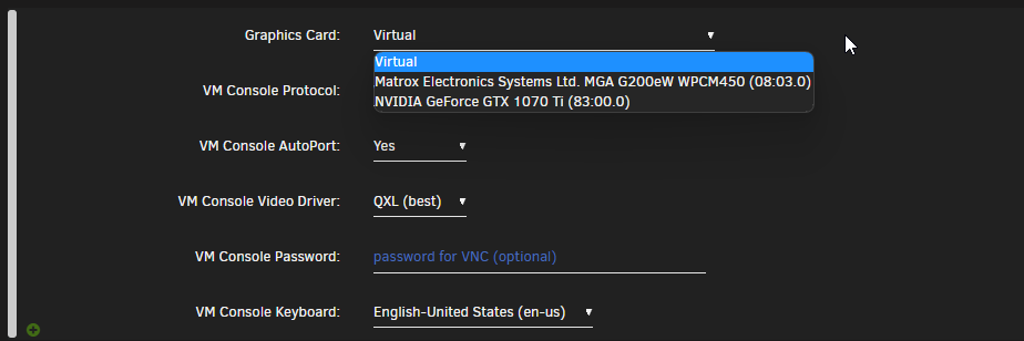

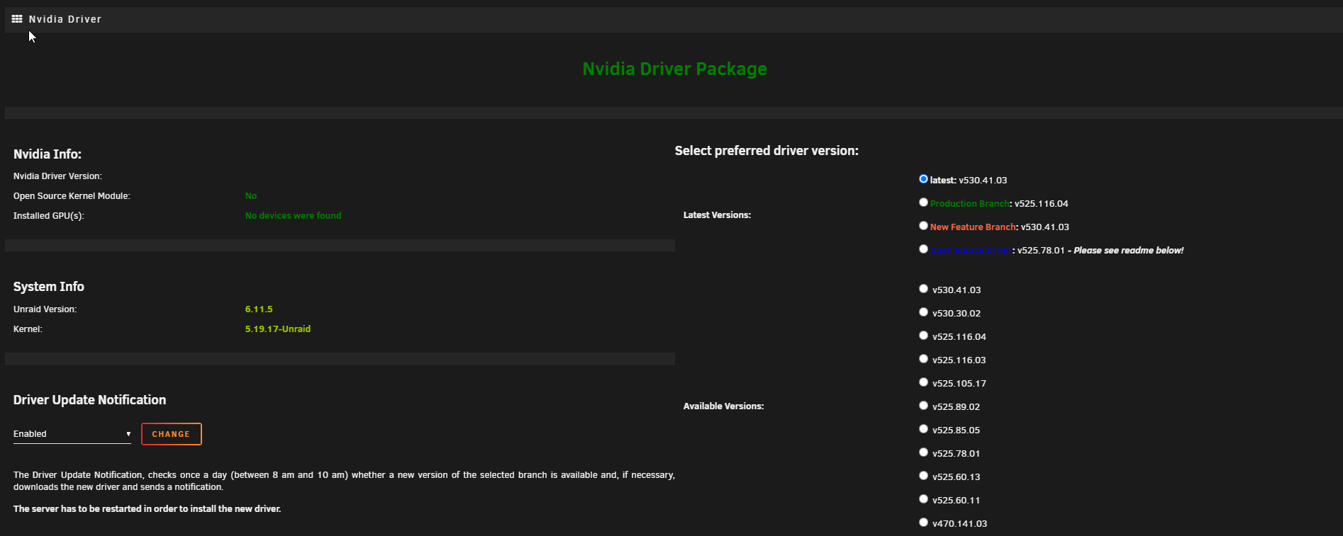

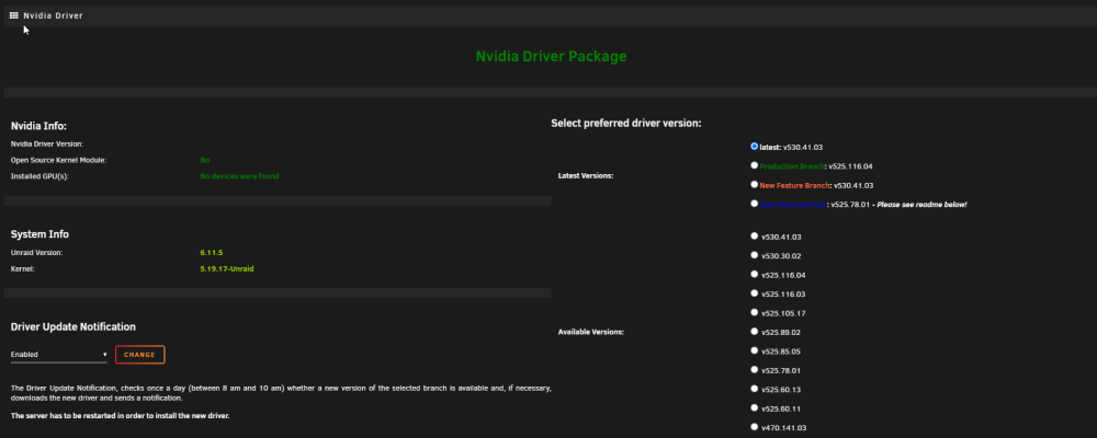

Hello, I installed an nvidia card in my server to help with plex transcoding. I installed the Nvidia Driver plugin, waited for all to finish. I disabled and re-enabled Docker and then I went to the plugin options. My card is not detected but it is detected in tools system device and when creating virtual machines. I restarted the server several times and I like even uninstalled and reinstalled the plugin but the card is still not detected

The driver is reporting this:
May 24 12:40:27 Tower kernel: NVRM: GPU 0000:83:00.0: GPU does not have the necessary power cables connected.
May 24 12:40:27 Tower kernel: NVRM: GPU 0000:83:00.0: RmInitAdapter failed! (0x24:0x1c:1428)
May 24 12:40:27 Tower kernel: NVRM: GPU 0000:83:00.0: rm_init_adapter failed, device minor number 0
Are you sure that you've connect everything properly? Please use the Nvidia support thread if you experience further issues.
