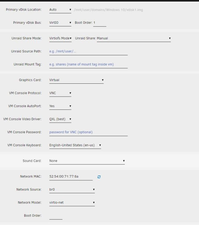

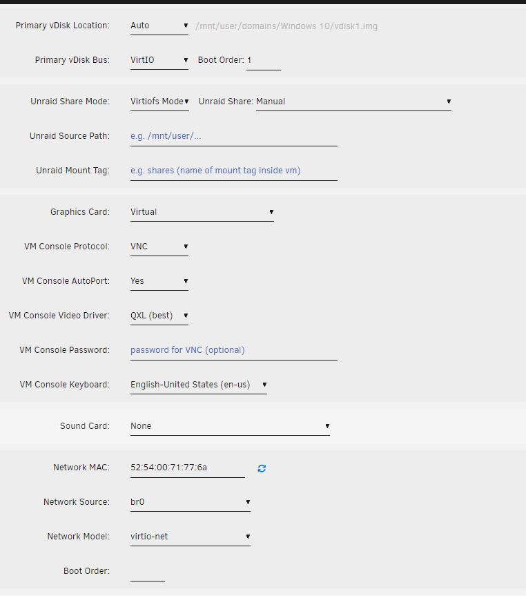

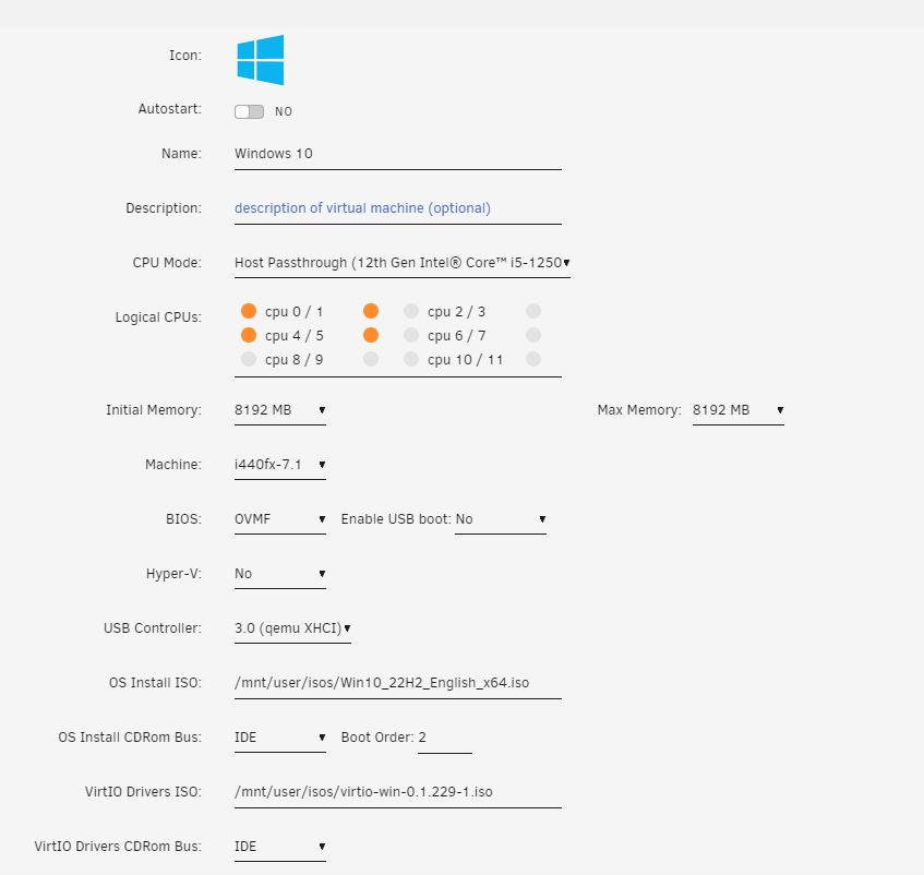

I'm doing something wrong here but I just can't figure it out. I'm trying to create a brand new Windows 10 VM from scratch. I have the latest VirtIO driver iso and set the following:
  • Primary vDisk Location: Auto
  • Primary vDisk Bus: VirtIO
  • Boot Order: 1

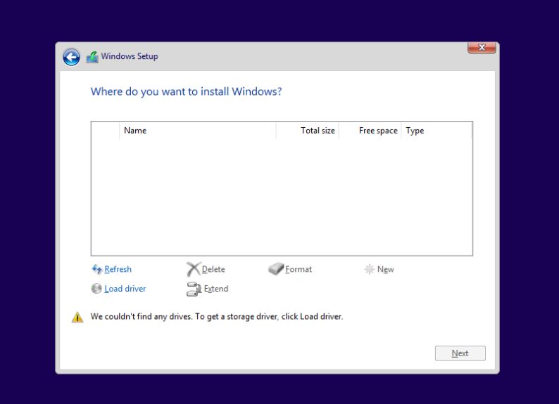

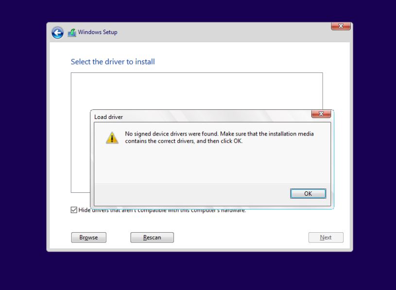

Windows doesn't detect any drives to install to, even when I try loading drivers from the VirtIO iso. If I change the vDisk Bus to SATA, it works and Windows shows a drive to install to. My understanding is that VirtIO is superior but regardless...what am I doing wrong? Why can't I install Windows 10 using VirtIO?
Any help will be greatly appreciated! Thank you
Solved by SimonF

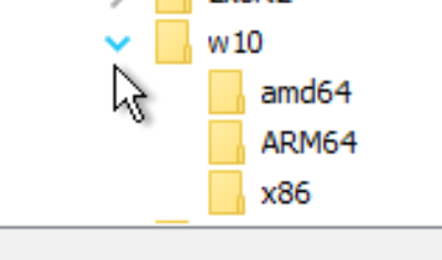

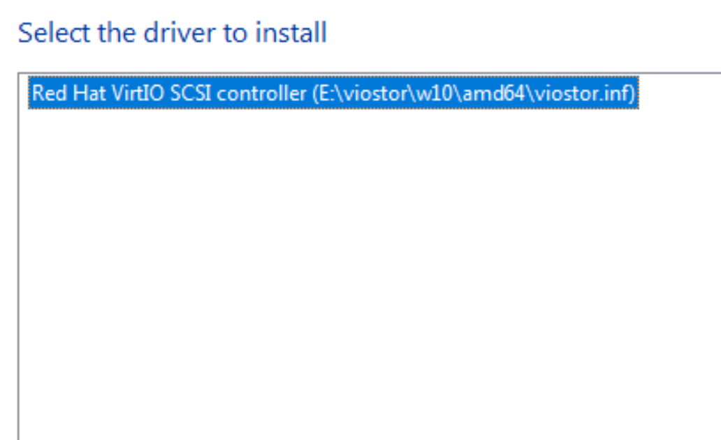

When you select browse and goto the virtio cd did you select viostor->windows 10->amd64 assuming x64
Yep I sure did! Did it a few times, tried different folders...the lot!

This is the folder that you should use: \viostor\w10\adm64 folder

have you tried sata for cd instead of ide?

I have been banging my head against this for like...two DAYS straight. That was me just facerolling over the keyboard. I switched it from IDE to SATA and now it's detecting the drive as it should. What the fudge cake banana.

The frusrating thing about this whole situation was that I already had a Windows 10 VM, but it crashed. I'd start it up but it wouldn't boot into Windows. It would either go to the recovery menu or BSOD with inaccessible boot device. I'd had it for months and I'd followed a couple of SI1 videos setting up VirtFS but for the life of me, I couldn't remember how I got it to install Windows in the first place.
Now I'll remember - change IDE to SATA for the install CD / iso
