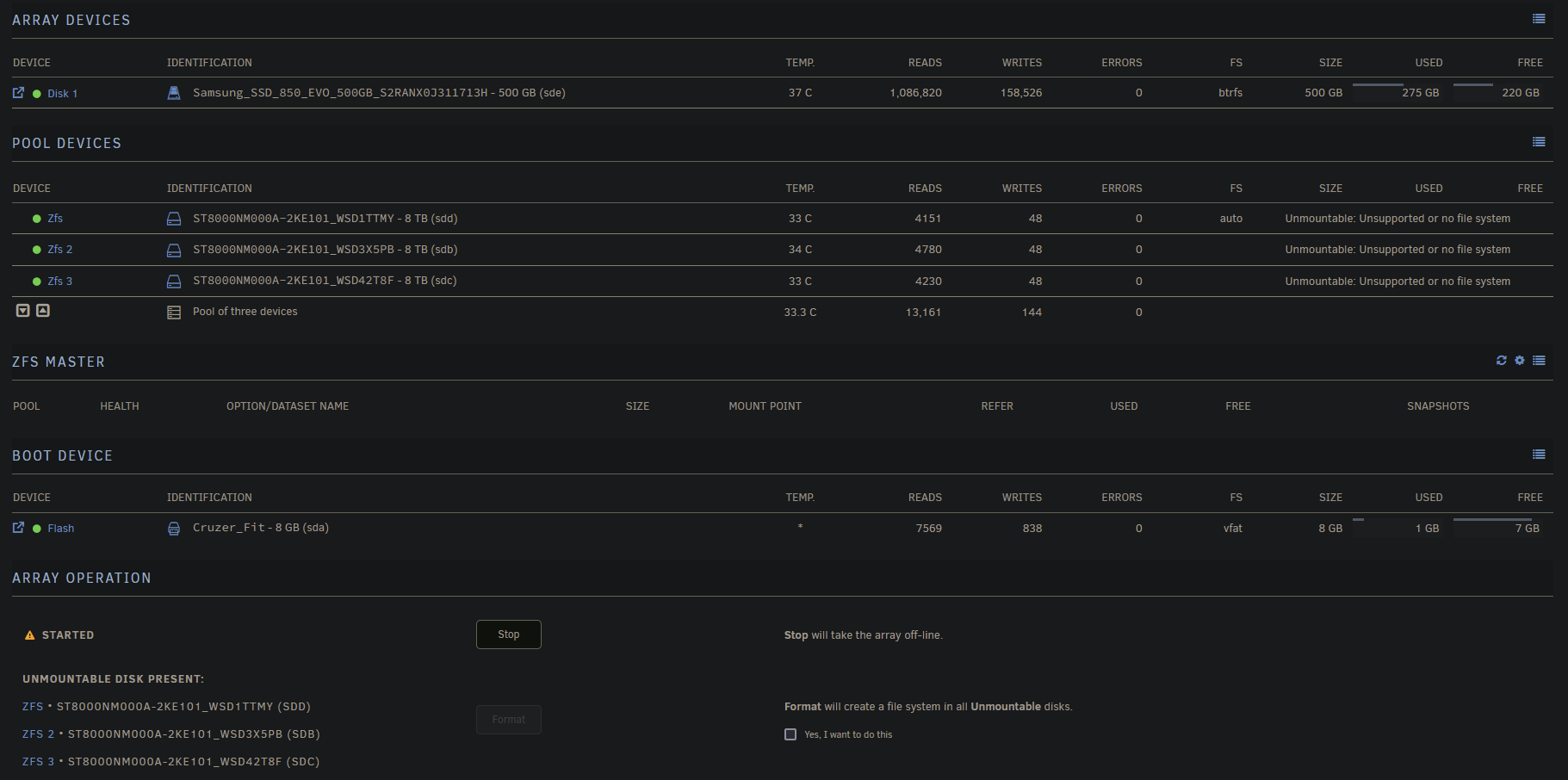

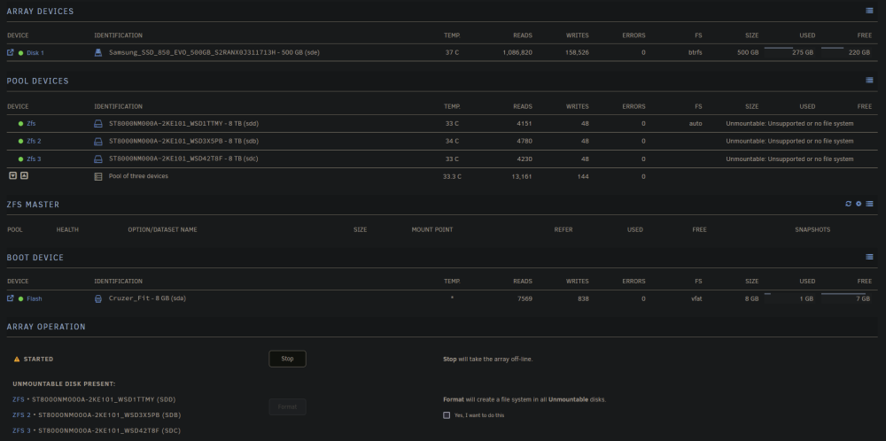

Out of nowhere the WebUI started crashing and the page would always go blank only coming back for a few seconds after refreshing the page many times, and I couldn't get the diagnostics because the page went blank in the middle of the process (through ssh it reported that there was no space left), but one thing that I've found odd is that Dockers kept working just fine.
The only way I found to get it working again was deleting disks.cfg from /boot/config and rebooting (and that was how I was able to generate the diagnostics file attached below), but after some time the problem always goes back.
So I'm pretty sure I've lost all my files, so before formatting them, is there any other useful data that I can attach here to prevent this from happening to me or other users? Before these problems begun I was trying to get Filerun (it's like Nexcloud) working with my ZFS volume (/mnt/zfs) as I had it working before reinstalling that docker, but it (filerun) couldn't recognize the files there, and at some point I tried running the docker on privileged status, I guess this might be the reason why my ZFS pool got corrupted.
Also, I had 5 Datasets in my ZFS pool, but now there is only 3 left with just a few files (but these where created by other dockers).
This ZFS pool was created with ZFS Master and Unassigned Devices Plugin (following SpaceInvaders video) and later on 6.12 I just straight up added to the pool and it was working just fine until now.

Also on Main page my SSD (the only array device) and the pool keeps constantly showing and disappearing from there lol (after this webgui becomes inaccessible, it doesn't load).
Diags are before array start, cannot see what the error is, I do see the pool is already online, pool cannot be online before Unraid tries to import it, export the pool using the command line:
zpool export zfs
start array and post new ones.

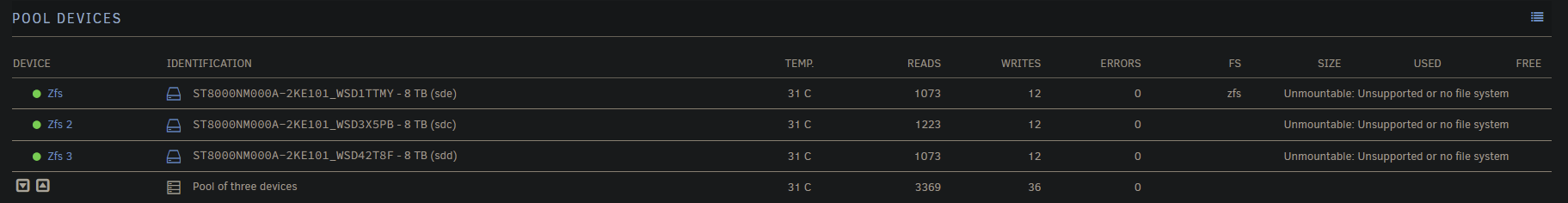

Well, it's stil ummountable, before doing this I also changed default file system to ZFS on Disk Settings and even tried with different pool names, but got the same results.

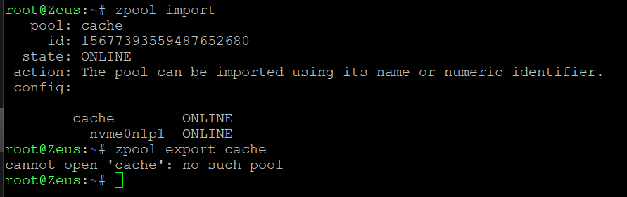

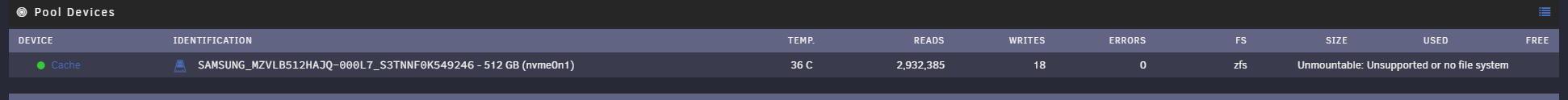

2 hours ago, xxbigfootxx said:
I've got this issue now on my nvme cache drive.
Post the output of:
zpool import
Output:
Now output of:
zpool import cache
41 minutes ago, JorgeB said:
Now output of:
zpool import cache
This:
Pool is damaged, if you don't have a backup try importing read-only:
zpool import -o readonly=on cache
If you have a backup destroy and re-create.
1 hour ago, JorgeB said:
Pool is damaged,
How'd it get damaged? It was working perfectly, then went offline for couple of hours and had to hard reboot it, would that have done it?
