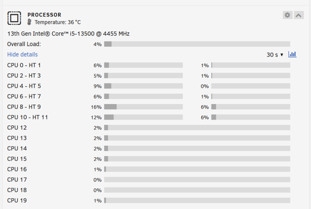

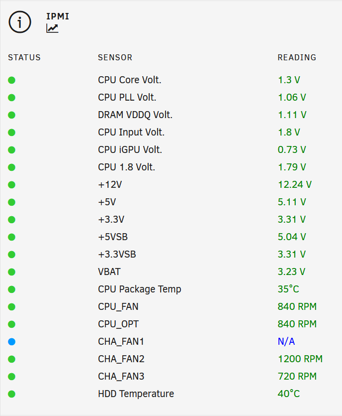

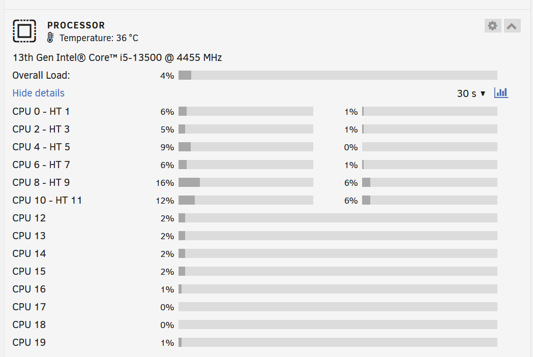

Did you ever get your i9 tamed?  I need to tame mine its running hot.
1 hour ago, theDrell said:
it keeps touching the 100c mark without my processor doing much.
Are you sure the CPU cooler is working? Mine is usually around a comfortable 36-40C, but I do have a Noctua NH-D15 cooler on it, which is large enough that it barely fits in my case (Fractal Design Node 804). My CPU isn't as powerful as yours (I've got an i5-13500) but the i9 shouldn't be *that* much higher. The heaviest thing I'm running is a Windows Server 2022 VM running Blue Iris recording six security cameras 24/7, pinned to CPU 8, 9, 10 and 11.
If you install the "IPMI Tools" plugin in Unraid, it'll let you see the fan speeds along with a bunch of other stats:
Edited by Daniel15
IMG_8374.thumb.png.040f4ccd9775b60d1c5094bb17cb1ff5.pngIMG_8373.thumb.png.8c7667102e57ca5c1767c93b663a74e6.png
I probably need to plug the motherboard fans into the IPMI card, but I was short on Molex connectors to get the 6 pin PCIE to it, although I have a route.  But yeah.
I am using a Noctua NH-D9L as my cpu cooler.
