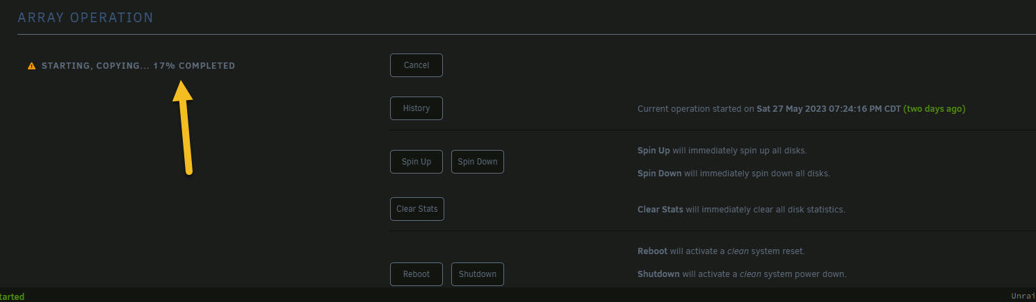

having an issue with a parity swap procedure --
i had a drive say it was bad, tried to reconstruct it - failed again, so i replaced, but only drive i had left was  a 14tb, and my parity was only a 12tb, so i had to use the parity swap procedure https://wiki.unraid.net/The_parity_swap_procedure
-- when i came back to check it a few hours later, 17% of the copy process was done, when i check ed the next morning, still only 17% done - and it has just stuck there.
not sure what i should do -- i have attached diagnostics  -- please note - i'm sorta an idiot when it comes to this stuff -- ie i know just enough to be dangerous
thx in advance for your help, as i'm a bit nervous on how to best proceed
mark

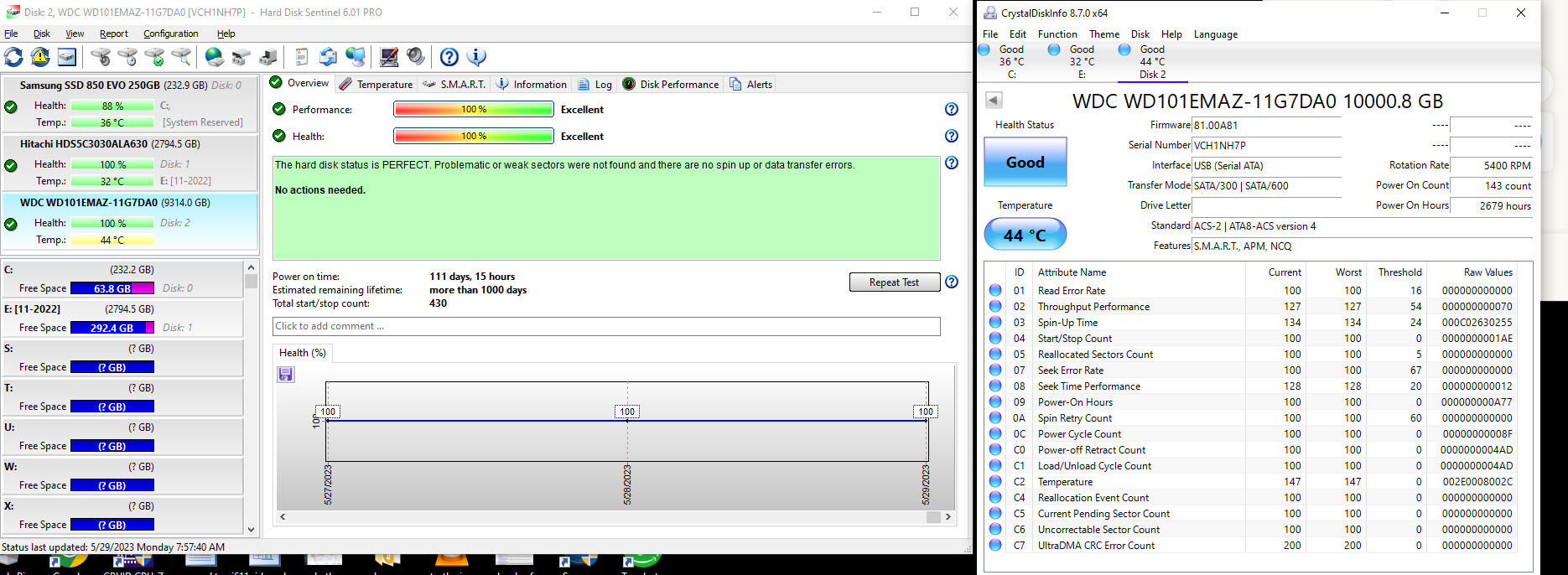

I only use my unraid servers for data storage, ie, they only run when i'm uploading or downloading files -- i've been having issues over the past year or so with unraid telling me i have a bad drive (red mark)  - when i remove the drive, all the hard drive tools i use say the drive is good (see attached as an example)
i'm pretty nervous about going in and replacing my sata controller, as it seems like that's where most of my recent probs are coming from -- but if i need to do so, i will.  that's just a bit above my skill set.
just trying to fx this solution once and for all :)
thoughts for best way to move forward for the long run?  in the meantime- i will boot down, replace the sata cable and re-start the parity swap procedure
