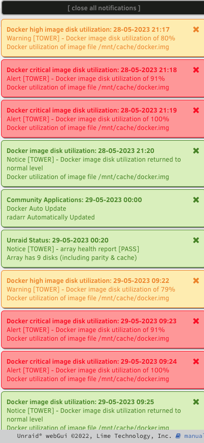

Screen shot attached. This keeps going back and forth between high usage and normal levels. Nothing is downloading, so I am unsure what I should be looking for or where. Thank you

Probably plex writing into an unmapped path.
So unmapped paths are stored in the docket instead of the array? Why would this just start all of a sudden? Hmm, actually I set up the audio imprint sonic thing fairly recently, maybe that’s it.
Yes, any locations not mapped to specific locations are stored in the docker image. Maybe plex did an update?
