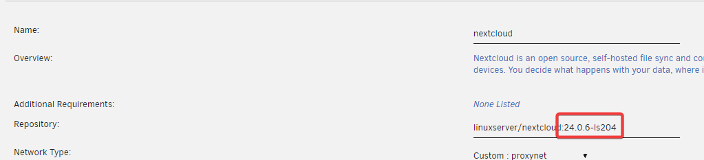

I found a way to progress past this error.
I added a tag onto my repo referenced in my container.
In my case I'm on V24 so I used this tag however all the tags can be found can be found here: https://hub.docker.com/r/linuxserver/nextcloud/tags
(This is assuming you're using the LinuxServer container, adjust for your own image creator of choice).
I then started my container up and ran the following command in the Console for Nexcloud container (I'm assuming the user is abc but I've seen it called other things in different OS'):
sudo -u abc php /config/www/nextcloud/updater/updater.phar
I kept doing this until my application was up to date (I tried running this command without changing the tag first, and I found it wouldn't progress past the error).
During the process I couldn't update any more...  I tried reverting back to the "latest" tag (by not imputting a tag), but i still got the error.
I changed to tag on the repo to a v25 tag (25.0.4) and was able to get back into the GUI and was able to keep updating. I was then presented with an update to v26.0.2 inside the GUI and the CLI updater.
Once I completed that I removed the tag off my application and restarted the docker again.

Thanks for this, was able to follow these steps and get Nextcloud back online.
Thanks for this. I didn't even know I was running on an older main version (v24), I only set this up from scratch a couple of months ago so would have assumed it was current.
I had nextcloud to auto update, I guess that was only auto update within that v24. I found the fix very useful, I am probably woahfully under knowledged in how to keep this working properly (sysadmin for 8 years). I don't know if anyone shares these thoughts, but the user friendlyness of all this is total garbage, start to finish. I thought containers were meant to be easier? When something goes wrong I feel like I am just guessing my way to fix with these container updates, I feel like I will just kill it randomly with these sort of fixes required
Bottom line, Nextcloud is different.
I was having the same kind of troubles.
I decided to go the nextcloud aio route and i don't regret it. It's not very easy to setup as it's quite different from a classical unraid docker install but once you have set it up it's really nice. Updates and backups are automated.
just wanted to share my story of a successful update.
Nextcloud was no longer accessible through web interface complaining about php v8.2 version.
My installed version of nextcloud was 25.0.4. (can be checked in nextcloud installation directory a file called: updater.log)
I changed the repository name as suggested by @tomwhi from: linuxserver/nextcloud to: linuxserver/nextcloud:24.0.6-ls204 and applied to the docker
From this point on nextcloud was accessible through web interface again.
From web interface started the usual update procedure.
In total there were two updates that completed one after the other.
Afterwards, i changed the repository back to linuxserver/nextcloud and applied.
Good luck!

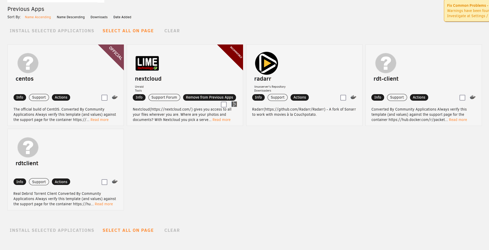

Now i cant find nextcloud in apps
Someone help me./
When i try to install , i get this error :
One or more ports used by this application are already in use by another service or app running on your server. You will need to adjust the host ports accordingly on the template
Edited by DrSiva2022
How about previous apps?
IT shows like this
help pls
