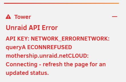

Rohit2122 Posted June 2, 2023 Share Posted June 2, 2023 Got this error after a restart. changed date and time to ntp -> yes. still having the same issue. any recommendations? tower-syslog-20230602-1238.zip tower-diagnostics-20230602-1345.zip Quote Link to comment

Rohit2122 Posted June 2, 2023 Author Share Posted June 2, 2023 tower-diagnostics-20230602-1734.zipSo I had an issue where the the motherboard time and date were wrong so I changed that to match IST (Irish Standard time) after that change in the bios I started up unraid. made sure ntp -> yes. The date and time were correct after this. Another weird thing I noticed was that I had my array auto start on boot up but now I have to do it manually. Could my usb be corrupt? Quote Link to comment
ljm42 Posted June 2, 2023 Share Posted June 2, 2023 FCP is reporting general networking issues (and a couple of other potential problems): Jun 2 15:47:01 Tower root: Fix Common Problems Version 2023.04.26 Jun 2 15:47:01 Tower root: Fix Common Problems: Error: Unable to communicate with GitHub.com Jun 2 15:47:01 Tower root: Fix Common Problems: Other Warning: Could not check for blacklisted plugins Jun 2 15:47:01 Tower root: Fix Common Problems: Error: Share games is identically named to a disk share Jun 2 15:47:02 Tower root: Fix Common Problems: Other Warning: Mover logging is enabled Jun 2 15:47:03 Tower root: Fix Common Problems: Warning: Legacy PCI Stubbing found Jun 2 15:47:03 Tower root: Fix Common Problems: Other Warning: Could not perform unknown plugins installed checks Being unable to connect to Unraid Connect is another symptom, it is not the cause. I moved this to general support because I don't see the issue, hoping to get more eyes on it. Quote Link to comment
Squid Posted June 2, 2023 Share Posted June 2, 2023 GATEWAY[0]="109.255.67.1" Very unusual to have the gateway set to be a WAN IP. Usually you set it to be the IP address of you router (likely 192.168.0.1) Quote Link to comment
