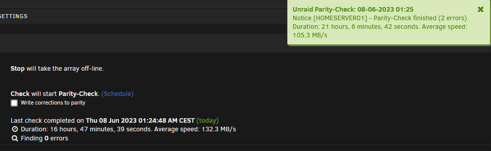

June 8, 20233 yr Author Ok so I did a rerun and I got this? On the notification it says 2 errors and in the main tap it says 0 errors? It also shows different Durations and speed? Also this is the Notification on telegram: HomeServer01: Notice [HOMESERVER01] - Parity-Check finished (2 errors) Unraid Parity-Check Notice [HOMESERVER01] - Parity-Check finished (2 errors) Duration: 21 hours, 6 minutes, 42 seconds. Average speed: 105.3 MB/s homeserver01-diagnostics-20230608-1529.zip Edited June 8, 20233 yr by MrYoshii
June 8, 20233 yr Community Expert Solution Syslog confirms no sync errors were found, notifications are known to sometimes show the wrong data, not clear yet the cause, but you're fine.
