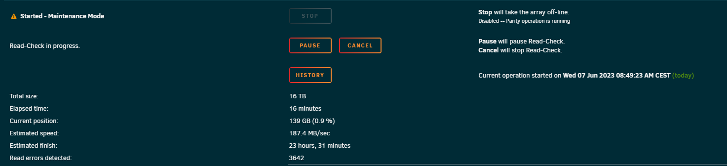

This morning I woke up to read failure errors on my 16TB disk, the disk drive not the parity disk.
I powered down the system, to replace old 8TB drive with the 4TB I replaced yesterday to see if the system would fully recognize the drive so I could swap the 16TB drive. I later found out that it's not possible to replace an lower disk for a higher disk.

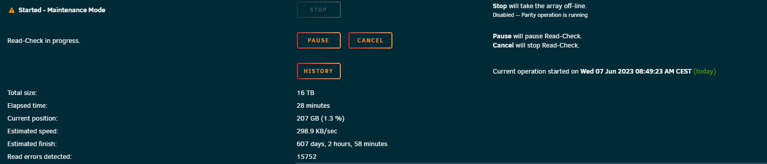

So I swapped the 8TB back for that 4TB. And at the moment it's doing a Read-check for the 16TB.
I noticed that the speed of the Read-check dropped to like 24mb/s 10 minutes in, and that the amount of errors increased.

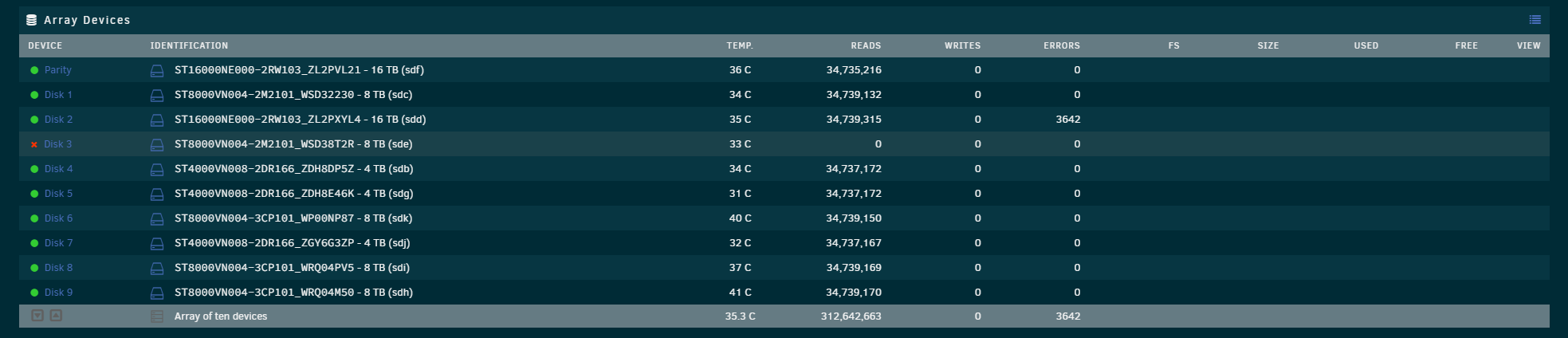

Errors increasing now.
Disk2 has a lot of pending sectors and failed SMART tests, so it need to be replaced, problem is that disk3 is disabled and you only have single parity, I assume you still have old disk3 at least?

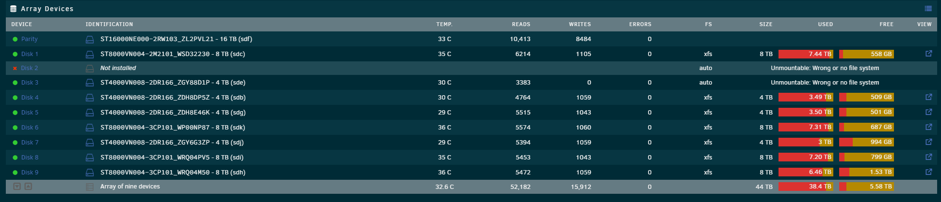

Yes, i still have the old disk3. But when I tried to swap it, it said that it couldn't because the old disk3 is smaller than the new disk3.
How do I get around that issue?
I guess if I  can make the old disk3 active again, and replace the disk2 I would have no data loss right?
You can do a new config and re-use old disk3, that will take care of that data, for disk2 you can try to copy everything you can from the current disk, of if there weren't any writes to the array since disk3 was replaced you try to force rebuild it, but that will only work if parity is still valid with the old disk.

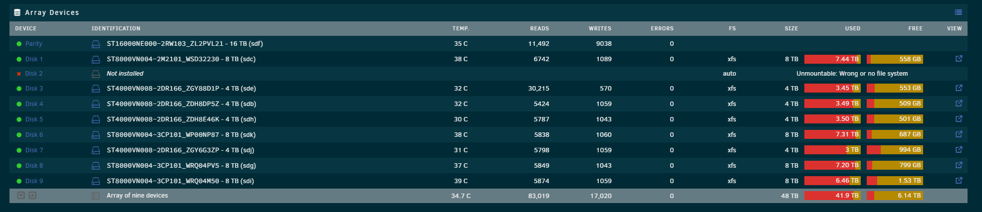

Nope, you can try if you want:
-Tools -> New Config -> Retain current configuration: All -> Apply
-Check all assignments and assign any missing disk(s) if needed, including the new disk2 and old disk3, new disk2 should be same size or larger than the old one
-IMPORTANT - Check both "parity is already valid" and "maintenance mode" and start the array (note that the GUI will still show that data on parity disk(s) will be overwritten, this is normal as it doesn't account for the checkbox, but it won't be as long as it's checked)
-Stop array
-Unassign disk2
-Start array (in normal mode now) and post new diags.

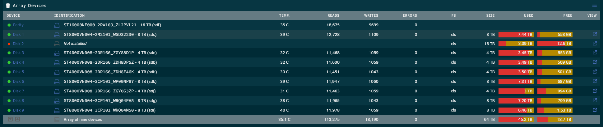

My replacement disk is coming tomorrow.
Why would you stop the array and unassign disk2?
Can't I just let it rebuild if it works?
Edited by Tornic
You need to unassign it so it gets disabled after the new config.
For now check filesystem on disk2, disk3 is having a strange error, will save that one for later.

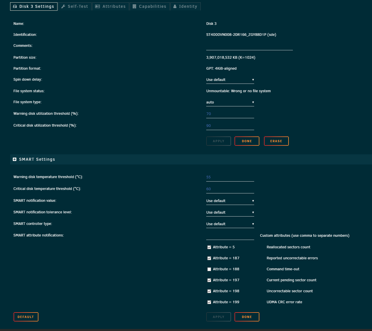

When I click the name of the disk what I want to test or repair. I don't see the "Check Filesystem Status" option.
What am I doing wrong?
Edited by Tornic
Change the filesystem from auto to xfs first.
I get the following.
Phase 1 - find and verify superblock... error reading superblock 4 -- seek to offset 4000786989056 failed couldn't verify primary superblock - attempted to perform I/O beyond EOF !!! attempting to find secondary superblock... .found candidate secondary superblock... verified secondary superblock... would write modified primary superblock Primary superblock would have been modified. Cannot proceed further in no_modify mode. Exiting now.
You need to run it without -n or nothing will be done, though not liking those beyond EOF errors.
