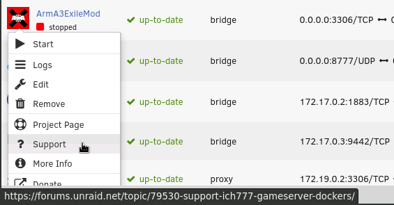

I got to this point by clicking on the arma3exilemod support link within the docker;
and posted this;

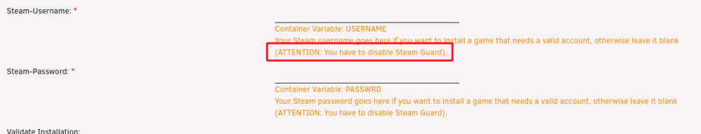

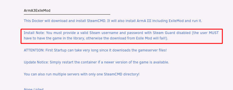

Please double check:
Anyways, your problem is pretty obvious:
1 hour ago, RSouls said:
code FAILED (Account Logon Denied)
Please read the description from the variables:
and also the description from the container itself:
If you have any further questions, please use the support thread.

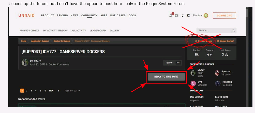

I have installed the ich777 arma3exilemod plugin and it is not working (see below for more info)
I'm seeking support, so I clicked on the support option;
It opens up the forum, but I don't have the option to post here - only in the Plugin System Forum.
Please don't start a new topic, you have to reply in the support thread.

24 minutes ago, RSouls said:
Thank you for not closing this thread - I can now reply to it.
You should reply in the support thread (you've even posted a screenshot where it is visible... :D ) :

The problem is not obvious to me: My user login and password are correct, but it requires a steam guard code which is sent to my email address.
Anyways, then your Steam Guard is not fully disabled.
I have a account where it works fine, but you also have to disable Email codes so to speak Steam Guard entirely.
I checked my steam account and went to manage steam guard.
The email notifications were still enabled.
After disabling this, and verifying - the logs now look promising;
