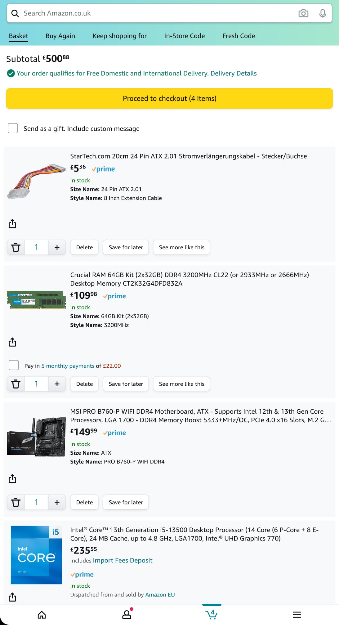

Hi All, just placed an order for an i5 13500 and MSI B760 motherboard to install into a spare supermicro chassis I have.
My current server is absolutely fine other than the power consumption so going to move away from the dual xeon I currently have which run constantly at around 150w
New build is going to cost just over £500 and the plan is to install into the supermicro chassis get unraid tested using a trial licence and move pro licence and drives over once everything is running smoothly. Ordered a front panel cable extension from ebay
1378270838_WhatsAppImage2023-06-07at12_13_49.thumb.jpg.4d2d01f8517ee78fbadb793d9ff4a55f.jpg
Once moved over I am hoping for to cut the power use by half with a bit of luck but will see how it looks.
The only other thing I am considering is 10GB nic to connect directly to my 10GB port on the Unifi Dream Machine SE. If anyone has any suggestions on what NIC to buy and use with DAC cable that would be great.
This build will mean moving away from ECC I have tried to stick to £500 budget. Might go over if the stock cooler doesnt fit

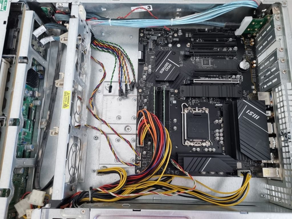

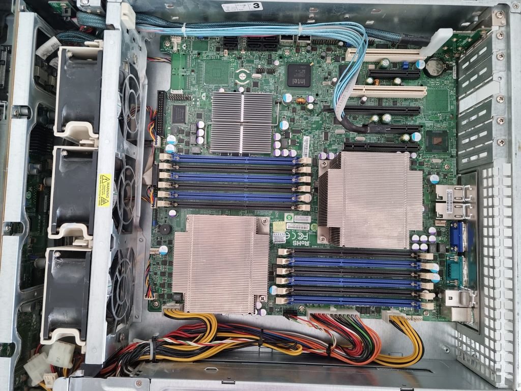

Made some progress today, got motherboard and memory installed, didnt require the ATX extension cable and connected to front panel connections that could be connected.
Just waiting for CPU to be delivered and a 4pin 3 way fan splitter
Does anyone know if I can still connect the PE Pin to Power Supply I2C (JPI2C1)
The Power Supply I2C Connector, located at
JPI2C1, monitors the status of the power sup-
ply, fan and system temperature.
Assuming this is supermicro specific and not available on MSI motherboard.

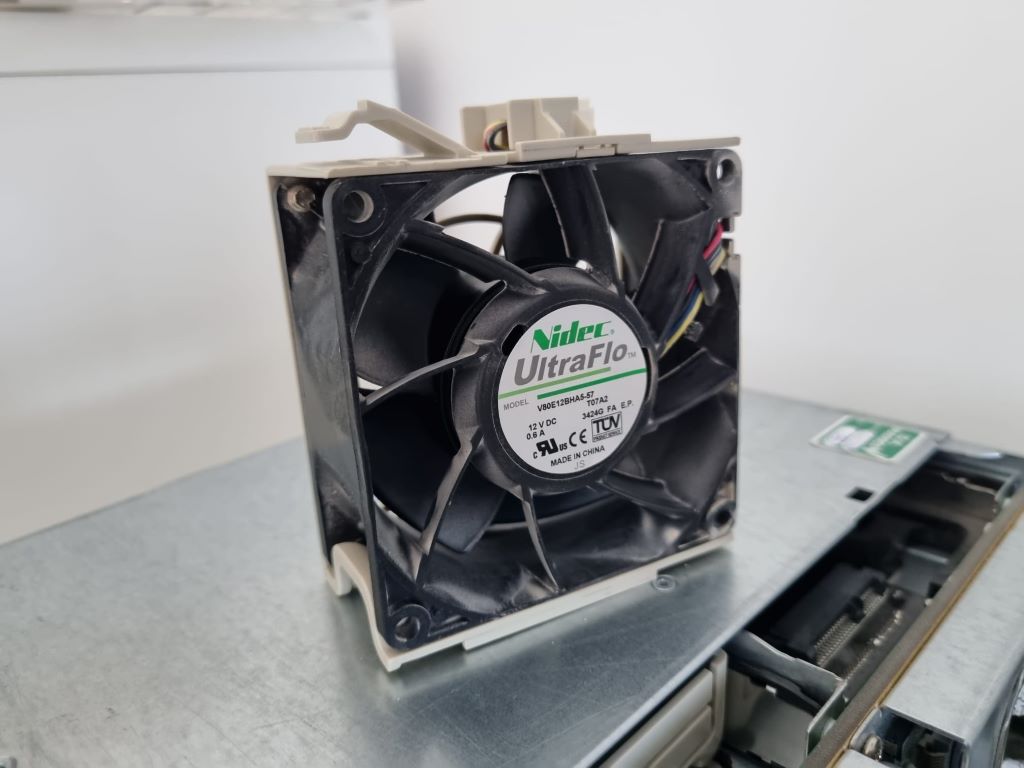

Before and After pic attached, also pic of fans I would like to replace with something better if anyone has any suggestions?

It should just work. One thing that needs attention are passed-through devices in vm's or docker containers.
Unfortunately you will have to find an alternative method of power monitoring.
Yep, just left it disconnected. Just added the front panel cable extension and usb header for motherboard.
Edited by bally12345
