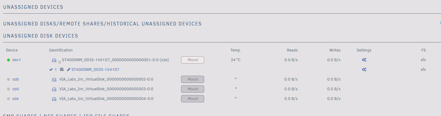

See if parity mounts with the UD plugin.
Unassigned Devices, you will have to install it.
ah since the parity drive is just a mirror of the one drive, just mount it into the old slot?
But creating a new config should also work as well, right?
But where would it be mounted, though? I my replacement disk. I could use the new drive as parity disk then and just mount this one shown  as data disk?
The point in this case with UD is to see if it actually mounts and you can access its files. If not, there may be some more that needs to be done.
