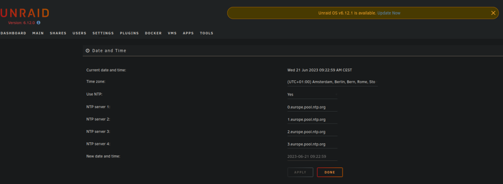

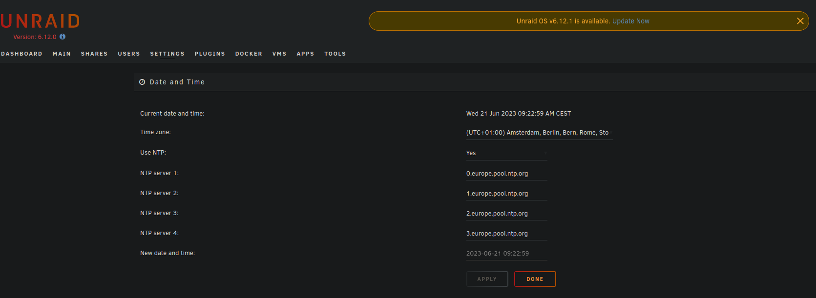

Is your time, date, and timre zone set correctly?
it looks like it is correctly configured
