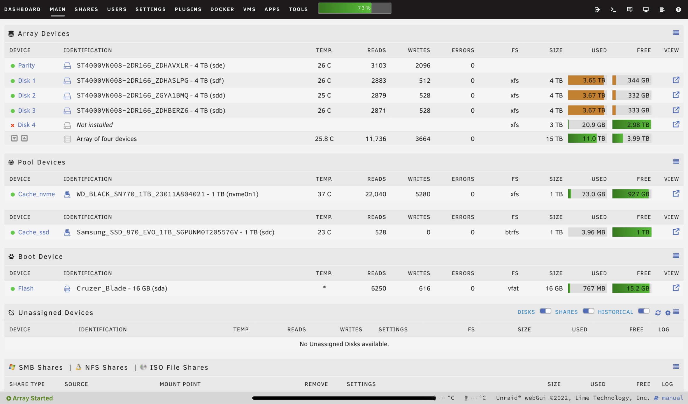

Thanks for the help, old array drive cleared and removed but can I ask I is it okay to just run with a missing disk in the array as shown, I will be taking the parity disk and replacing with a new disk and adding the existing parity disk to the array ?
Solved, sorry I am impatient and have decided to create a new config as it could be next weekend before my new disk arrives

I was just going to tell you to do that :)
