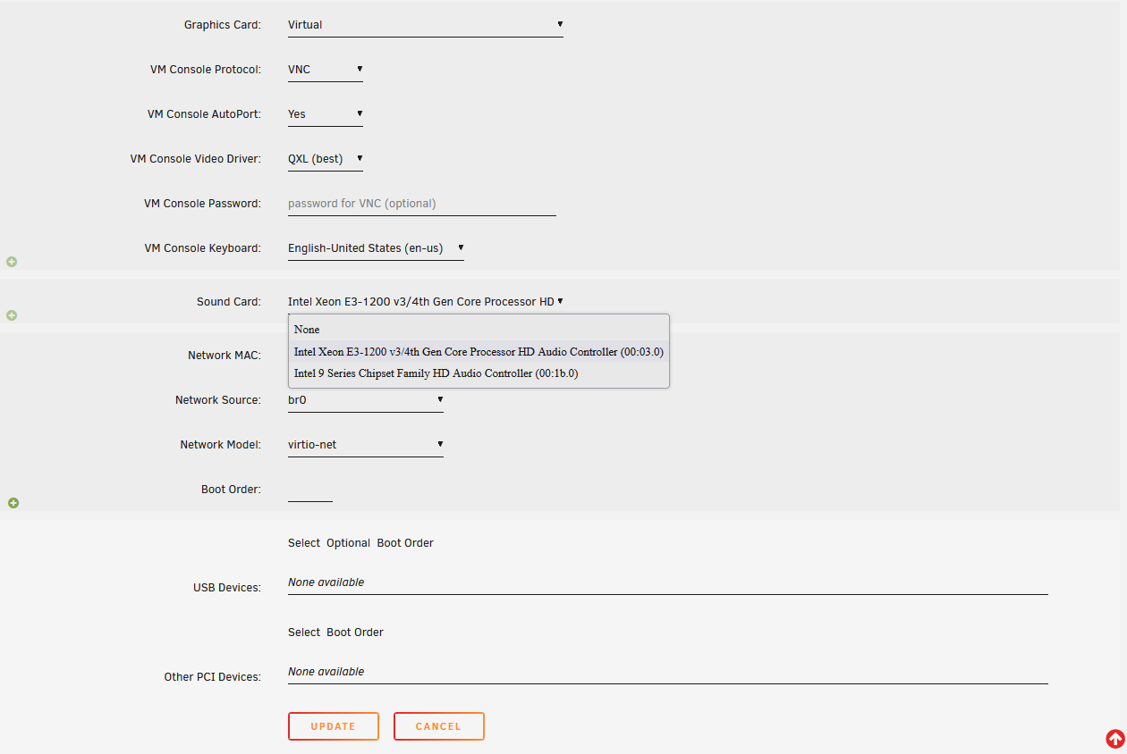

I am attaching a screenshot of the VM's relevat hardware settings. It is my understanding that hardware needs to be passed through to the VM. However, neither of the two options provided fixes the issue of volumio not producing sound via Toslink.

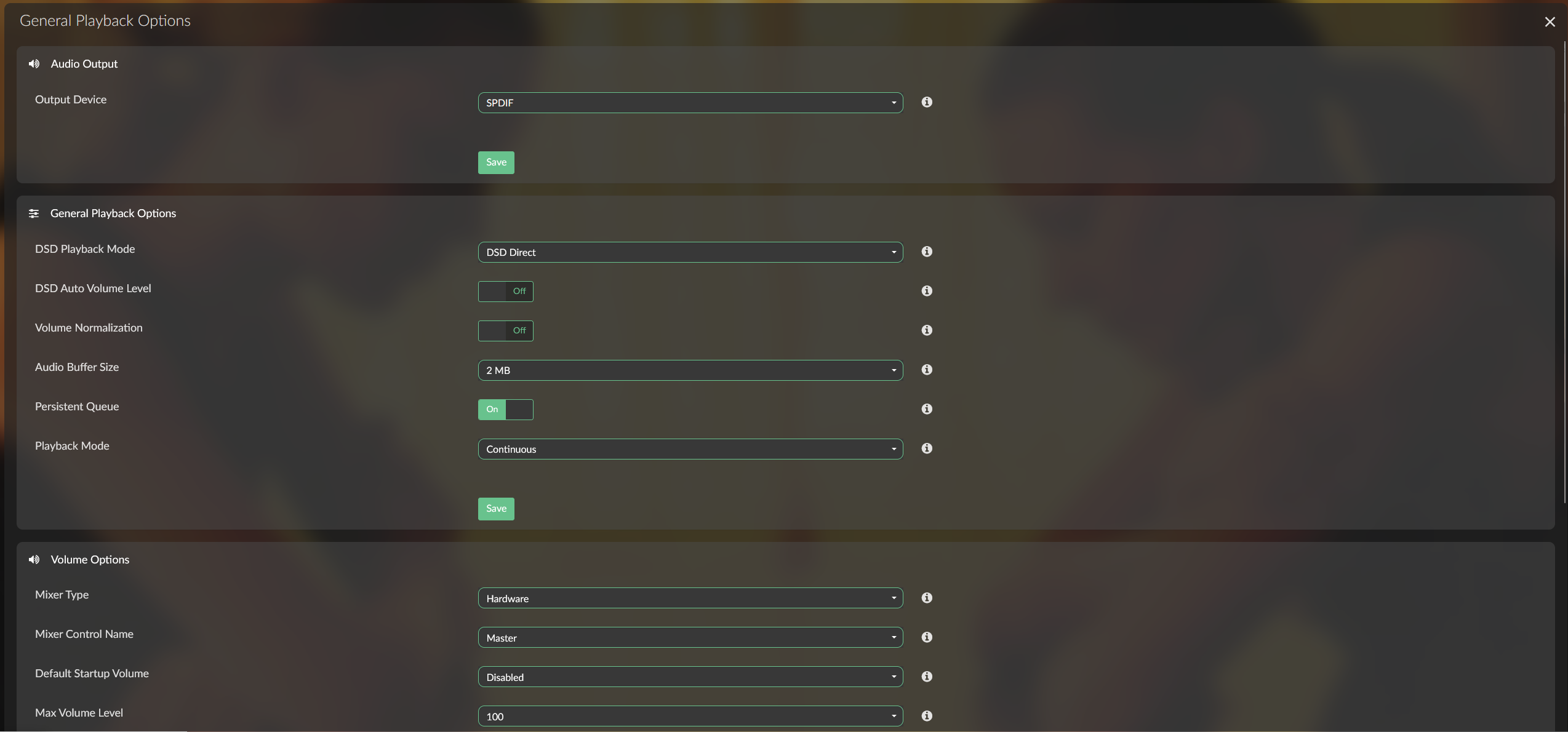

Of course, the issue could also be with Volumio - I'm attaching a screenshot of the relevant setting there as well.

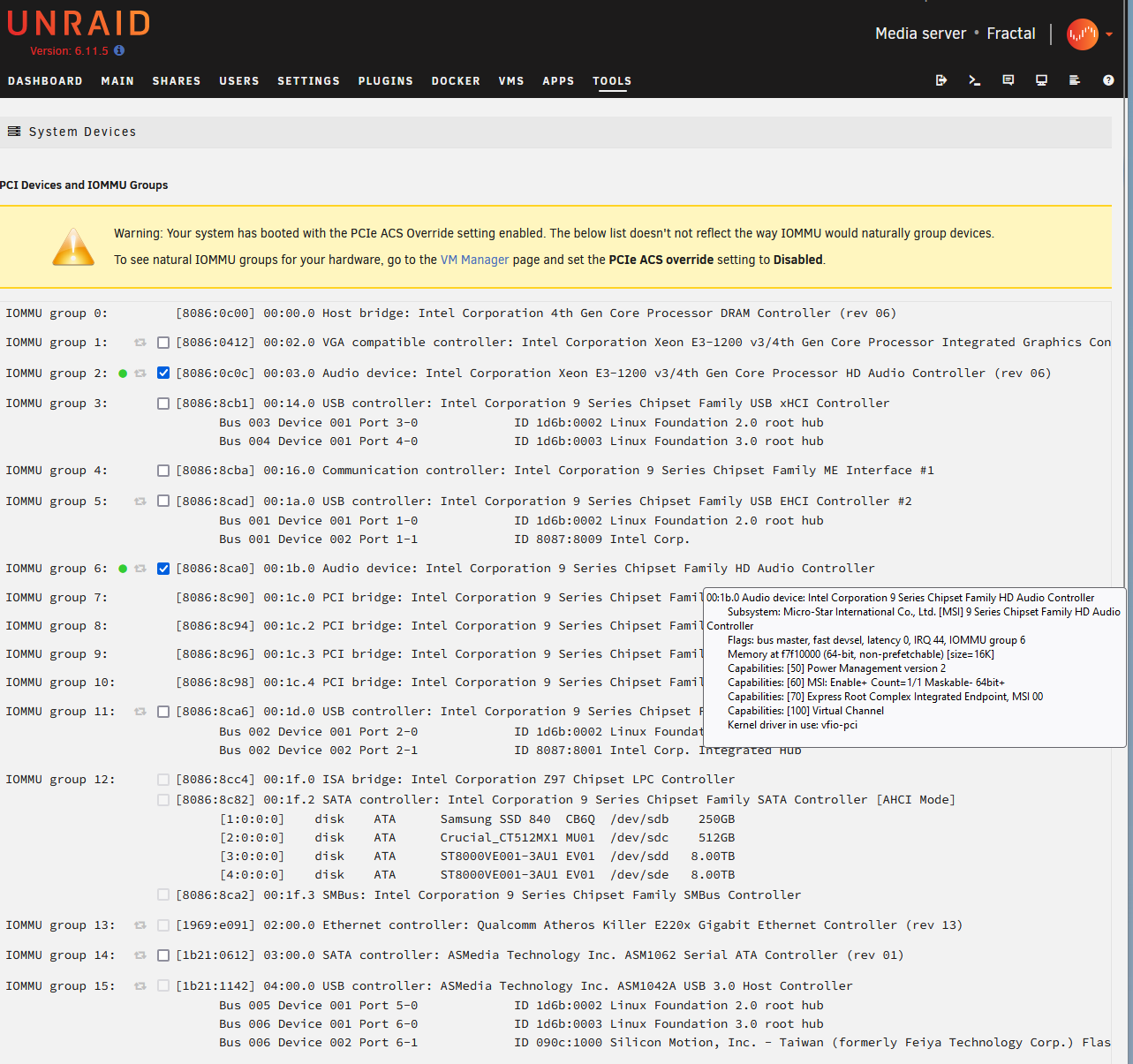

Do you mean the unraid System Devices tool? I'm attaching a screenshot. The selection of the two audio devices, as well as the PCIe ACS Override setting being enabled, are results of my previous attempts to get it to work.
