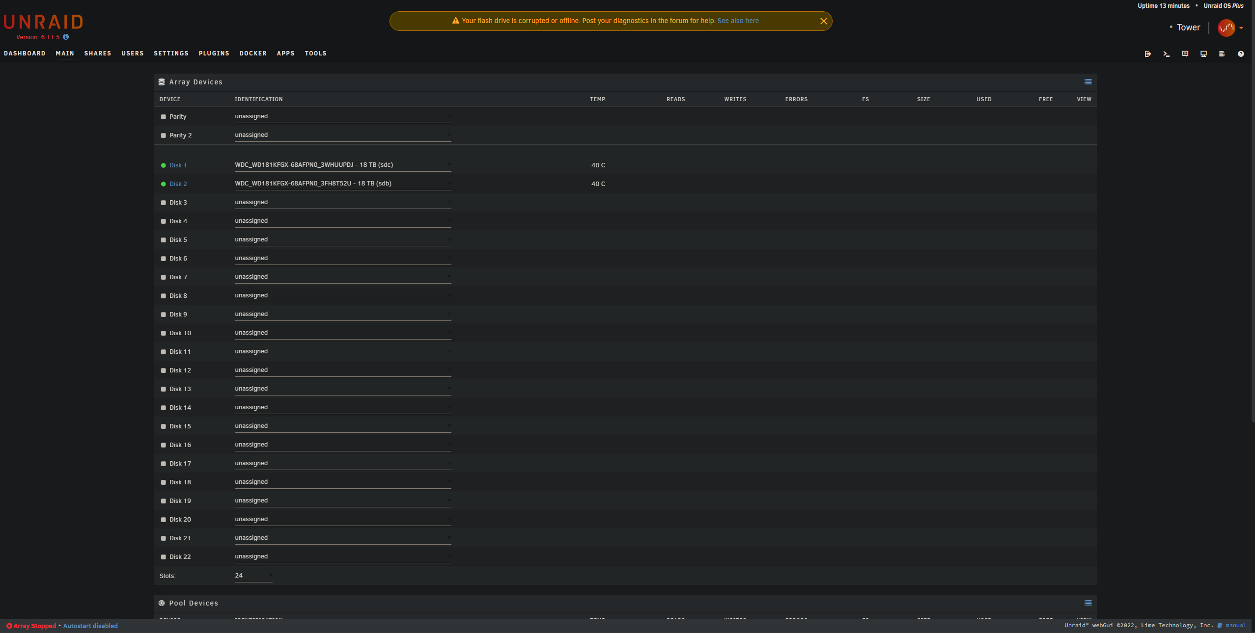

PROBLEM HERE: Anyway, there is a yellow notification on top that said 'Your flash drive is corrupted or offline. Post your diagnostics in the forum for help.'

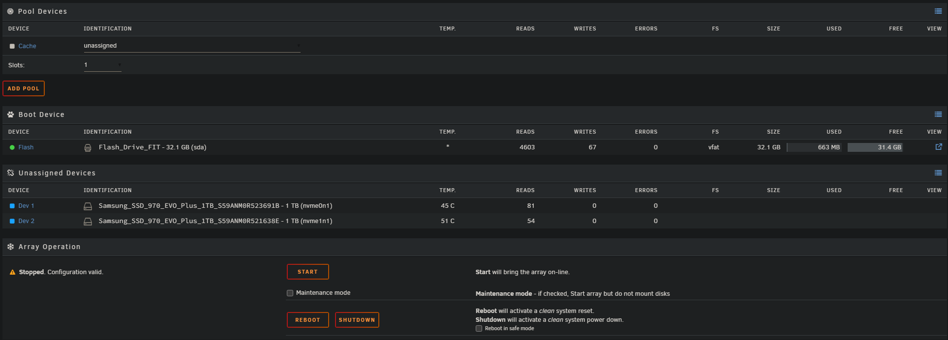

I was trying to access my server via (http://iboolnas.local/Dashboard) and it was not responding, so instead I went to (192.168.1.100), and it looked depressing.
Everything unassigned, everything off, like the first time I booted UNRAID.
So... here is the file, please help 😢
Right here below the first time it said something like: "unlcean shutdown was detected, reboot the system to something something". So I rebooted, but now the message is gone.

You may find this section of the online documentation accessible via the ‘Manual’ link at the bottom of the GUI or the DOCS link at the top of each forum page to be of use.   You should first backup the ‘config’ folder from the flash drive as that contains any configuration information.
