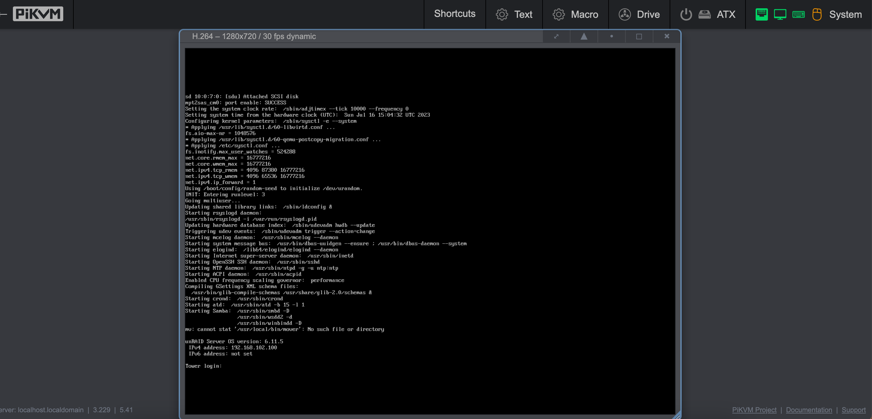

July 16, 20233 yr On 6/11/2023 at 11:22 AM, kpallen1 said: Hi, Recently my server has started shutting down at random times. Sometimes when I restart it, it shows that there was an unclean shutdown. Other times it restarts and appears as if it never shut down. The uptime will show as though the shut down never happened. This server is about 10 years old now, so I'm guessing it's some sort of hardware problem. I'm an amateur when it comes to this though and don't understand how to check the diagnostics to see if says what's happening. Would somebody mind taking a look for me? Thanks in advance! tower-diagnostics-20230611-1310.zip 101.76 kB · 1 download I'm not saying this will solve your issue at all but I did purchase, put together, and install a PiKVM. I was having some random issues, and I'm not home very much, so it was very hard to diagnose what it could be. Turns out my issue is a bad USB key. But what was great is that even with unraid having crashed, so I couldn't pulled any diagnostic, I was able to pull up the piKVM and see the error codes there. If you're sitting next to your server and have a monitor on it then that's great but for me it's been a life saver. Luckily I don't have any errors to show at the moment but here's a current screenshot of it.
