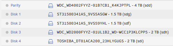

So given the table below, if i rearrange the drive physically... when I boot back up Unraid will just put them in the right order?  That just does not make sense to me.  So, it tracks the serial number to assign the slot and it really is that transparent?  Years ago when I built the machine and cabled the 3x2 5.25 racks, I assumed that the racks were top down and they are actually bottom up so my OCD has driven me nuts for years as the top drive is not sda followed by sdb, sdc, sdd and so on.

Yes - you can simply reorder the physical drives to match the GUI and reboot and the order in the GUI will stay unchanged.
So, will I need to do a new config, or just reorder in the slot assignments and bring the array up?
Unraid assigns the disks based on the drive's serial number.
You assigned Disk 1 to 9VS5AGSW
You assigned Disk 2 to 9VS59YHL
It does not matter if you physically move the drives or switch the controller cables from one connector on the motherboard (or even install a new controller and connect the drive to that).  9VS5AGSW will still be assigned Disk 1 and 9VS59YHL assigned Disk 2.
