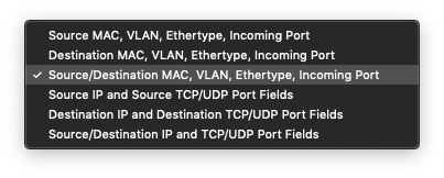

Since I've done this before, on the same core switches, everything is OK and the switch reports something is going on, the my logical conclusion is that the wrong load balancing scheme is set. It's set to Source/Destination MAC,
VLAN, Ethertype, Incoming Port, this is the default; layer 2 only but it supports layer 4 load balancing as well.
I'm gonna screenshot it if that's OK, I'm dyslexic and I'm sure I'll write all nonsense if I try to transcribe them:
The other switch supports a much shorter set of load balancing modes:
It sort of matches, if you take out VLAN and Ethertype which I believe you can't — at least Ethertype — they're just not specified in the bottom switch's screenshot.
