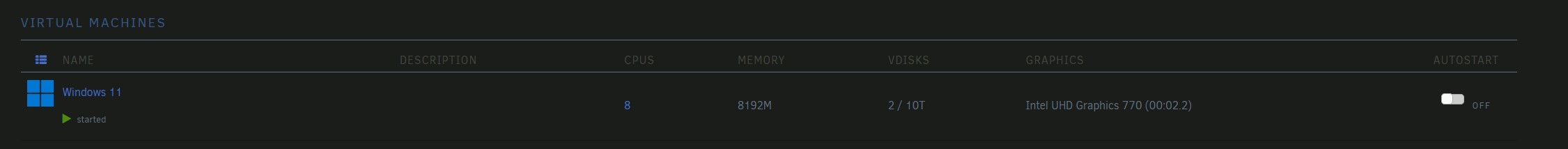

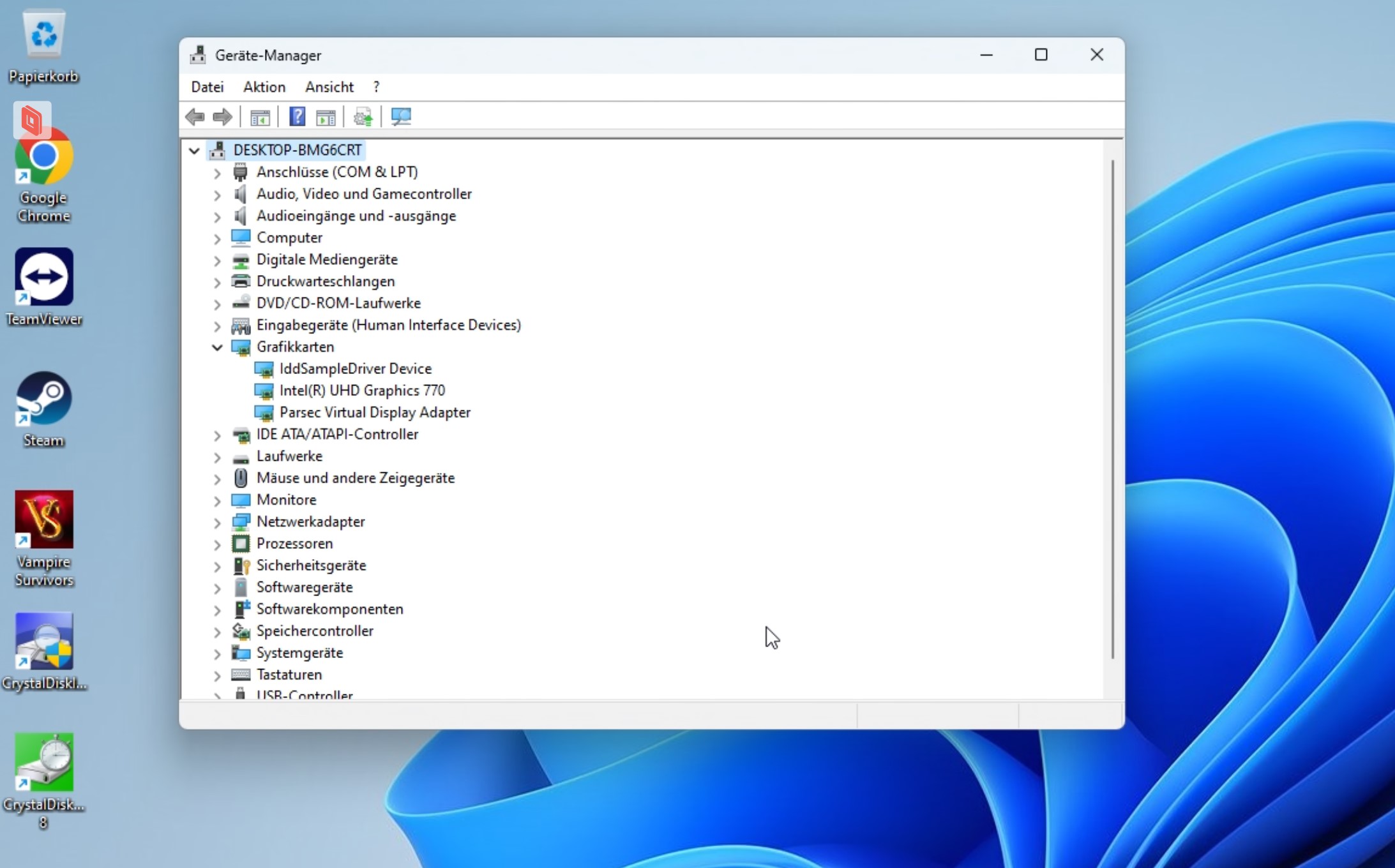

6 hours ago, 0xMDIV said:
Hey, just wanted to ask, did you try to game on it? im building a system with a 13900k, but i want to have a win11 vm for gaming and so on.
but kinda scared of performance issues ngl
I do. Vampire survivors and low qualitiy Games and Emulators. I have the sr-iov Plugin installed and use a Win11tiny VM for that. You can use Parsec and Sunshine for that. Works like Charm.
Iam still finding my Way around SteamHeadless for my 3060 in this server but thats not a Priority right now.
