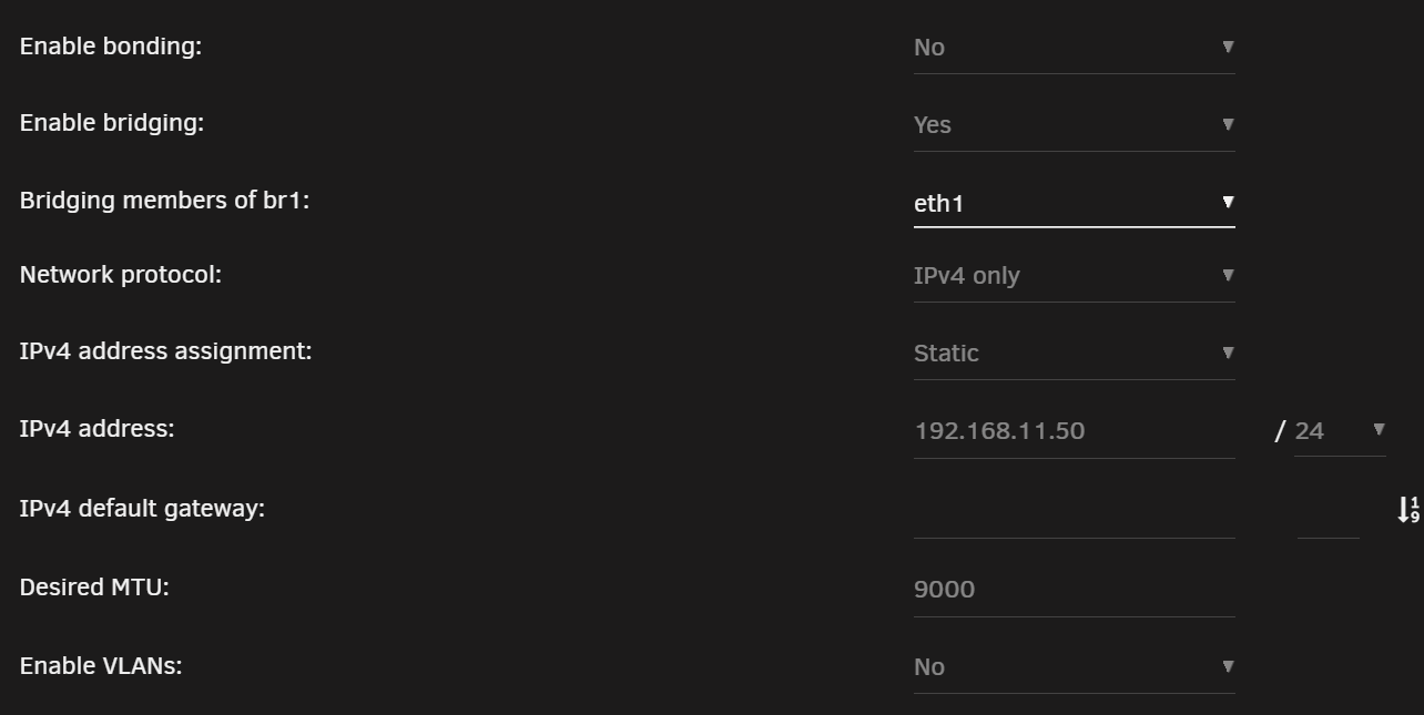

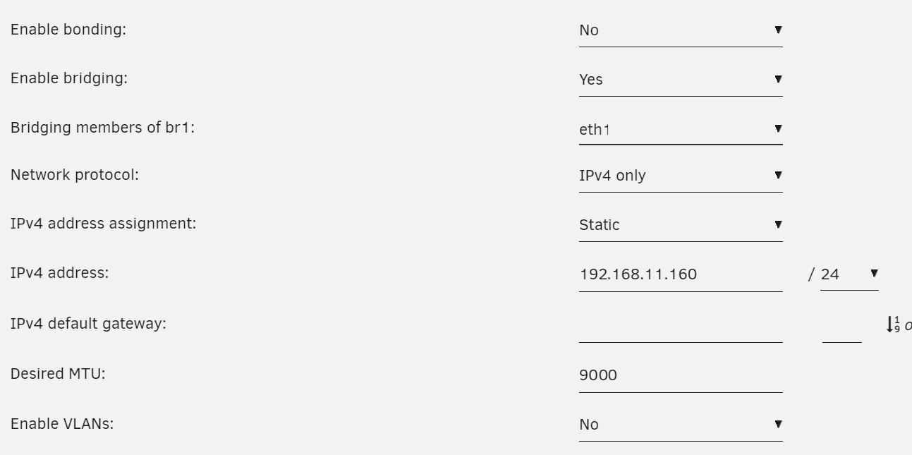

This can definitely work. So eth0 on each server should be connected to your normal switch. If eth0 on both is 10g and you have a 10g switch then I wouldn't bother with the steps below. But if one or both servers can't connect to the main network at 10g then the steps below will let the two servers talk to each other at 10g while still using eth0 to talk to everything else.
Direct connect the 10g nics on each server and statically assign them to a new subnet with unique IP addresses and no gateway.
In my case, my eth0 IPs were:
server1: 192.168.10.50
server2: 192.168.10.160
So I made my direct-connected 10g eth1 IPs:
server1: 192.168.11.50
server2: 192.168.11.160
so it would be easy to keep them straight.
I generally say to avoid jumbo frames, but since this subnet will *only* have these two computers on it, as long as you change the MTU of both to 9000 then jumbo frames should give a small speed boost. It is critical that every computer on this network have the same MTU.
When connecting between the systems it is *important* to use the IP addresses on this subnet and not a name like "tower". You want to be sure the servers actually talk over this network.
