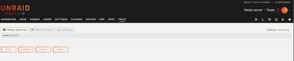

Thanks, am I supposed to see the results here? 1623502297_Screenshot2023-06-14193102.thumb.png.5045a66efbf10ee06153f72c652362a3.png
Both your appdata share and system share exist on both the cache drive and disk 1.
Stop the docker service (settings, docker) and then run mover from Main and see if that makes a difference.
This was it!  thank you
