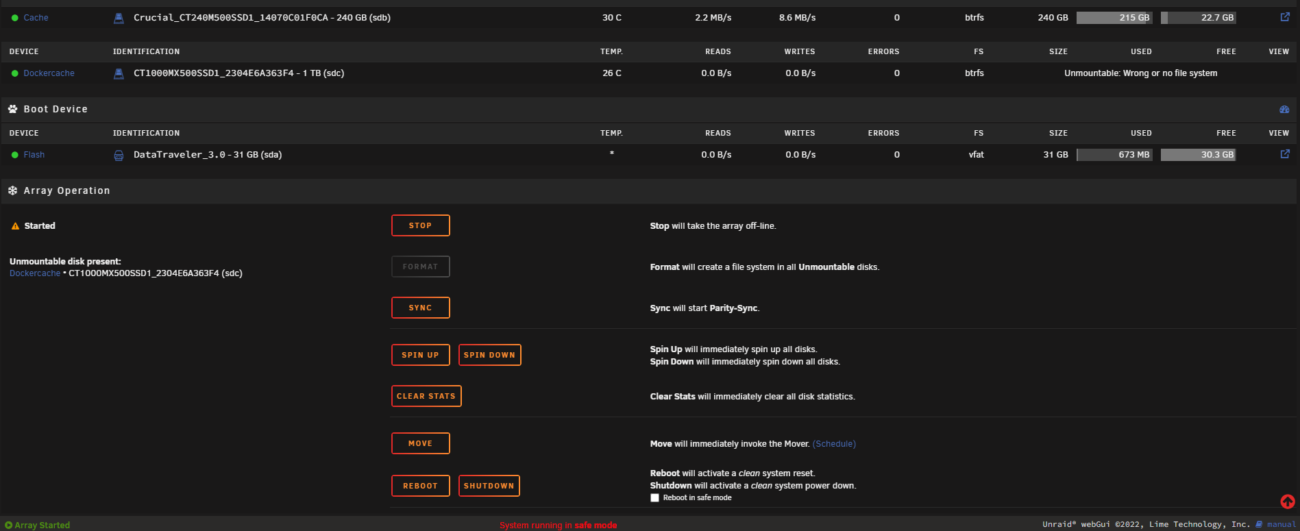

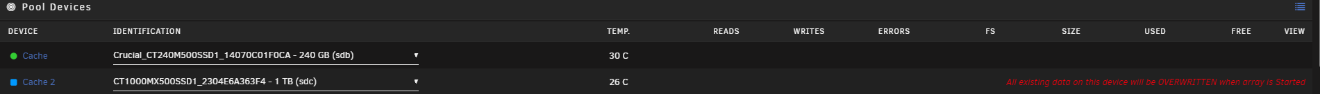

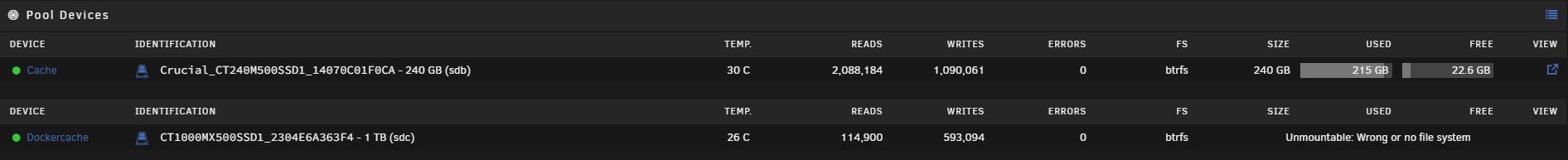

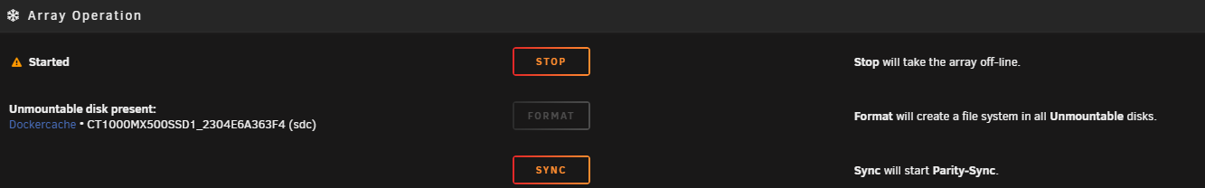

Now I have the next Problem.
I created a 2nd Pool, now the new disk is unmountable and the format button is grey.
I set the file System on the new Cache disk drive to btrfs.
Maybe its doin something in the background, i cant see?
There should be a "Yes, I want to do this" box below the format button, what Unraid release? Also post the diagnostics.
Release: Version: 6.11.5
I know that checkbox, but it doesnt appear on my system...

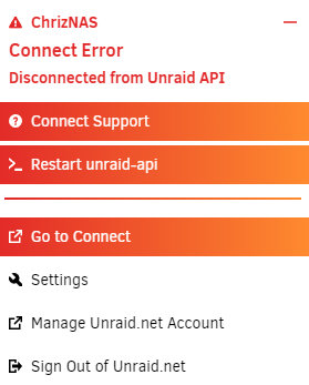

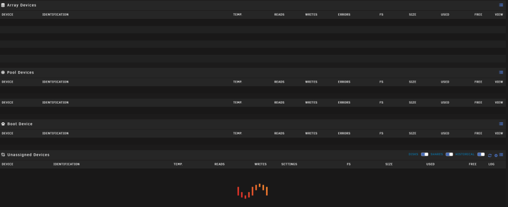

when i stop the paritycheck after starting the array, my server wont show disks etc and is loading till nirvana...
And i also lose my connection to myUnraid...

Try rebooting in safe mode, and if you are using Firefox try a different browser.
u think that will help with the unmountable problem?
bcoz the other probslems are gone after 15mins of wating.
Using Chrome...
It may help, your GUI is not working correctly, if it's plugin related safe mode will help, though most likely it won't help, and if it doesn't there's a more serious issue.
in safe mode its the same issue... :(

Strange, now when i rebooted for the 3rd time in Safe Mode and Back to normal i have the Checkbox that says i want to Format...
I literally didnt do anything except for rebooting 3 Times in Safe Mode and Back.
Now its working!
Ty 😃

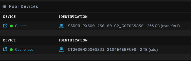

On 6/15/2023 at 1:52 PM, JorgeB said:
Correct, I assume current pool was btrfs? If yes it will default to raid1, to use the full pool capacity (without redundancy) you then need to convert the pool to single profile.
I know it's an old topic, but I'd like to be sure about what I want to do in a couple of days.
So right now, as You can see below I have one Cache Drive (nvme one) which is set up for appdata, and system.
The second SSD drive "Cache_ssd) is only for data - when it's almost full it is moved to my main array disks.
I've ordered new (the same model and capacity as the first cache_ssd) drive to have IN TOTAL 4TB of available space for new data.
The problem is that I don't want to move now files that are now stored on Cache_ssd.
As I already checked this drive its in mode:
Data, single: total=1.46TiB, used=1.46TiB
System, DUP: total=8.00MiB, used=176.00KiB
Metadata, DUP: total=2.00GiB, used=1.63GiB
GlobalReserve, single: total=512.00MiB, used=0.00B
So, my question is, If I be able to add second exactly the same SSD drive to installed one WITHOUT losing my data?
Cache_ssd is in BTRFS format.
Thanks.
If nothing goes wrong yes, you just add to the pool and start the array, initially it will be balanced to raid1, but you can cancel and balance to raid0, if you want to use the full capacity without redundancy.
