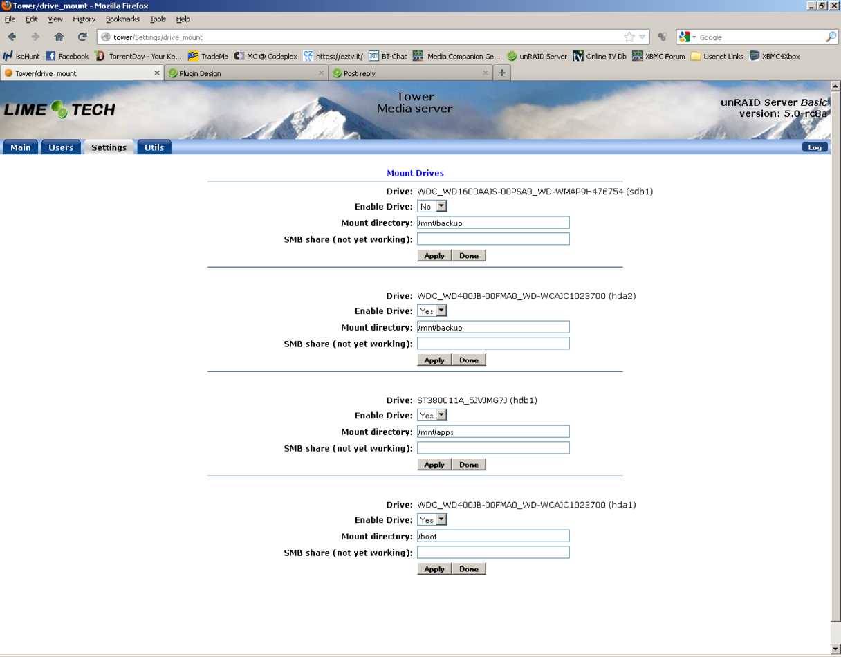

Hi Benni
Great job on this Plugin.  Fantastic.
One small glitch, I can't seem to select "No" and hit apply.  They won't unmount.  Actually, seems to take a very long time to disable.

most drives are gone from /mnt but still show as "Yes" in enable drive.
But, this isn't really an issue for me, as once I have it all set up how I want, the drive will be running all the time.
make sure, that nothing is still accessing those drives.
i've added a better unmount to my todo-list.
