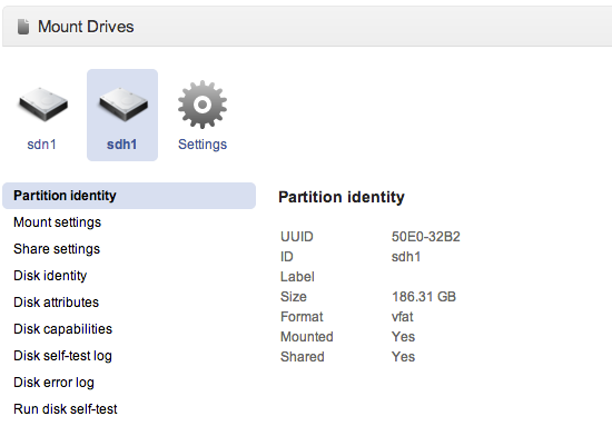

i just uploaded a new version to github. this is the start of a complete rewrite (again) :)
the big new feature in this version is a new UI, which is a lot cleaner. since i'm using some javascript functions included in the simple features plugin (and optimized the UI for the simple features UI), the SF plugin is now a requirement.
(In my opinion, the core simple features should replace the default unraid ui. it's a lot cleaner and gives more information on a quick glance.)
Only the core simple features plugin is required, but if you also install the disk_health plugin, you get those features with non-array disks, too.
(if there is a big demand for a simple features free version, i'll add one, but this has low priority for me)
the UI is not complete, there will be other changes. and the framework below will change in the coming weeks, too.
Note: Sharing is still somewhat beta. in my tests, i had no trouble sharing a reiserfs formatted disk. but i couldn't share a fat32 formatted disk. currently i don't really know, why. (didn't test with ntfs yet.)
