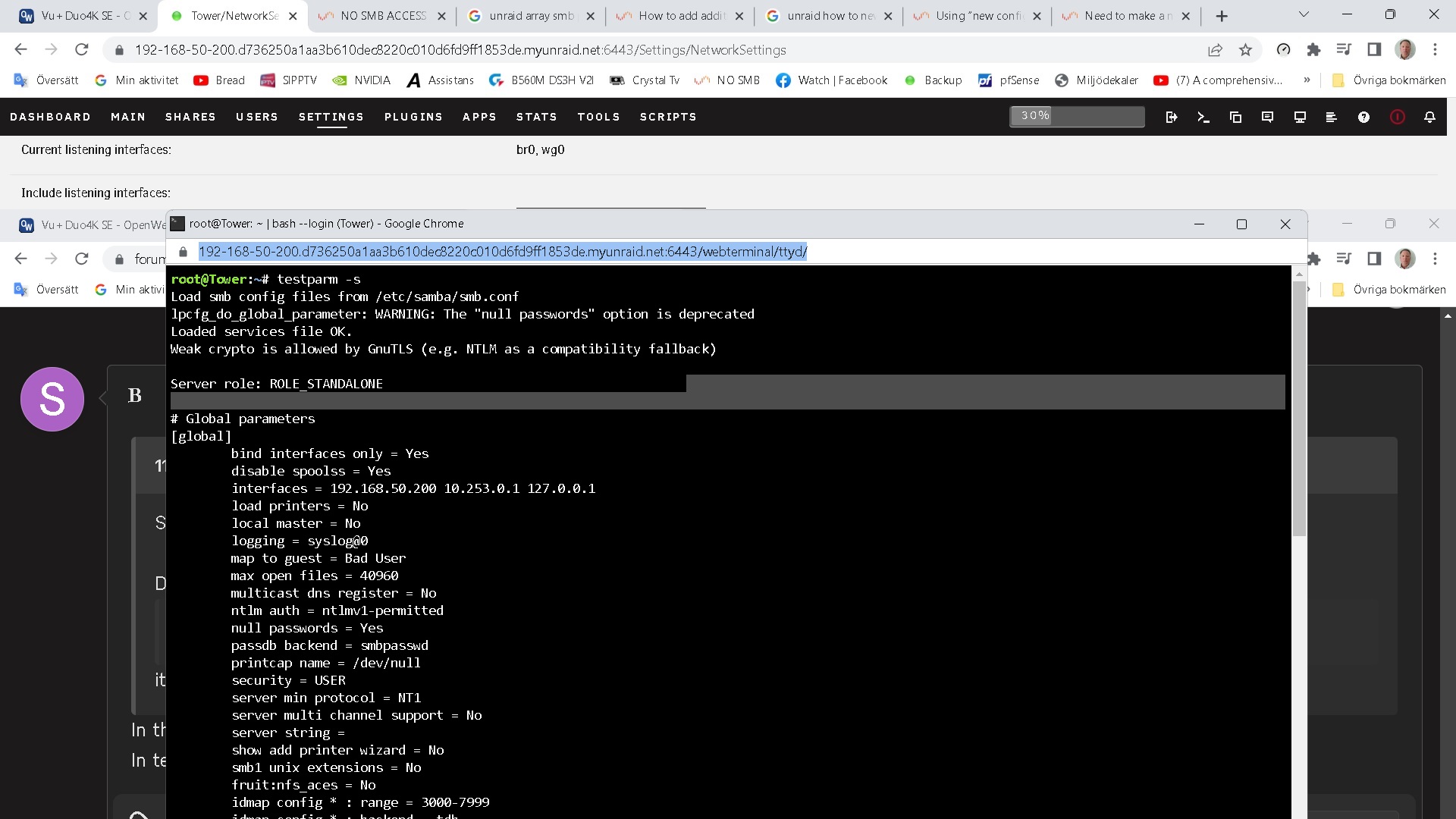

I believe you might have an interface issue.  These are the interfaces in your 'testparm' output:
interfaces = 192.168.50.200 10.253.0.1 127.0.0.1
Check that these look right.  The 192.168.50.200 is your server.  The issue might be the application of the interfaces/networking is not taking on first boot.  The are networking changes new to 6.12.
When this happens go to a command line and do this command:
/etc/rc.d/rc.samba restart
and see if SMB will work.

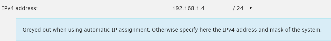

I see one thing I'd like you to check.  Take a look at your networking setup and confirm this setting:
I'm suspicious because the 'interfaces' in my test system shows:
interfaces = 192.168.1.4/24 127.0.0.1
notice the /24?  You're missing the mask.  This really shouldn't have anything to do with needing to restart Samba, but I'm a little suspicious the 'interfaces' is not getting set properly in a certain case keeping SMB shares from being visible, and a Samba restart fixes it.

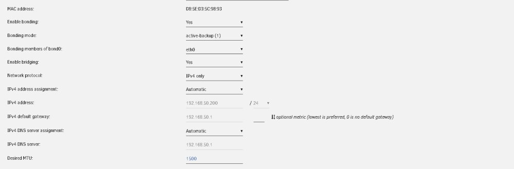

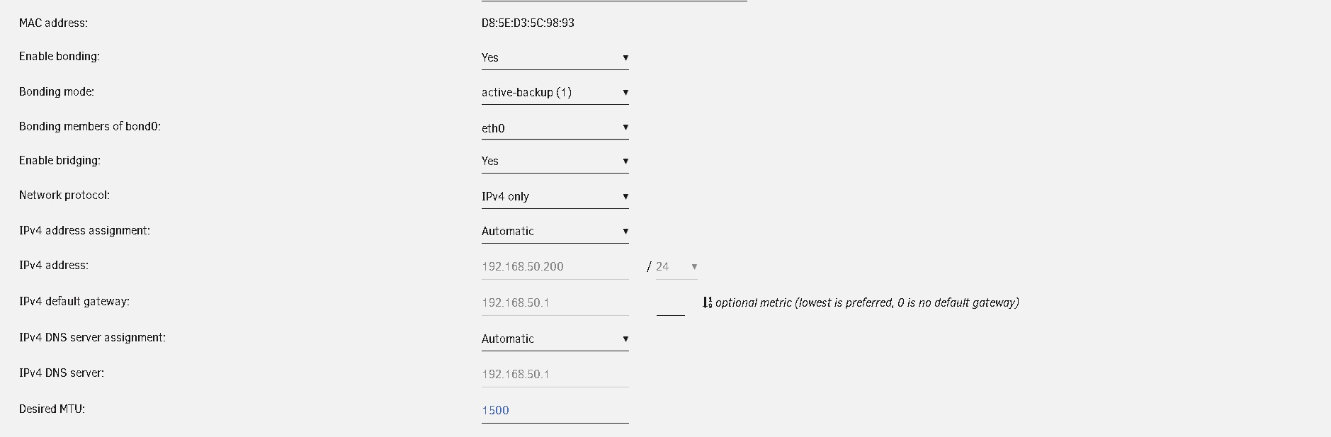

Hi and thanks, the Wireguard is my VPN services for accessing the LAN outside the home, i use the a lot, The /24 is automatical configured by Unraid
So it shows 192.168.50.200/24 in the network setup?
Do this command when SMB is working and see if the 'interfaces' command has the /24 added to 192.168.50.200:
testparm -s
it will be near the top.
testparm -s
In the setup my interface is 192.168.50.200:24
In testparm -s not there are just those tree interfaces but no /24

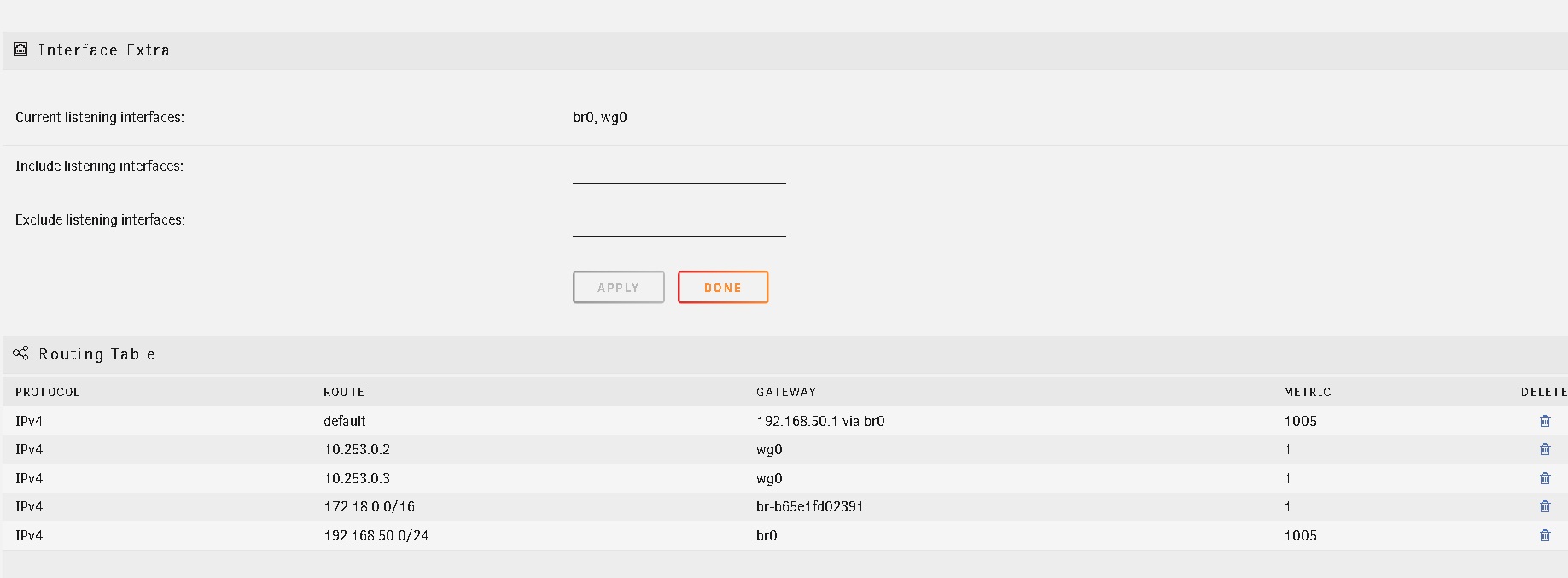

2 minutes ago, dlandon said:
It all looks right.  See if you have this setting in Wireguard:
Yes, same as your
