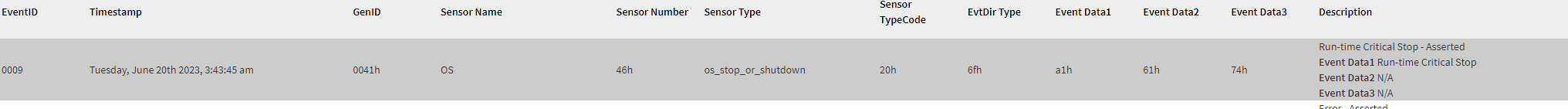

The server had a crash - but the log didnt capture  anthing in the logs not sure why.
This is my IPMI showing a run-time critical stopimage.thumb.png.041e0c120e30d31a0251e71aa92b84d5.png
