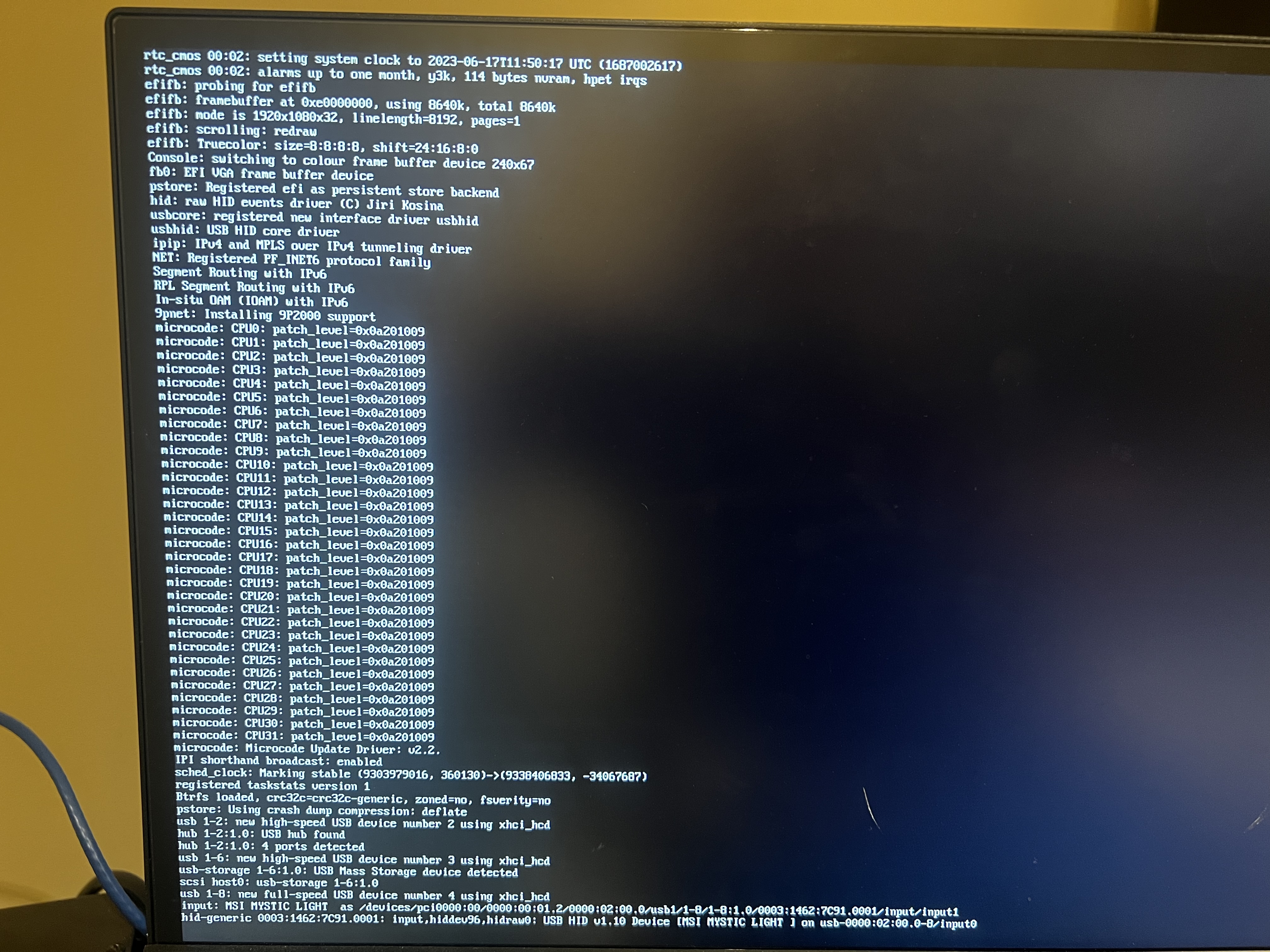

So this morning, with a fresh pair of eyes, I took a new Philips 32GB stick and used the USB Flash Creator with 6.11.5.  I then copied my entire "config" folder to it from copy of my old USB stick that I made on Windows 10 over to the new Flash drive.  I ran "make bootable" as an administrator and everything went ok.
I put the stick in my server and try to boot it.  It hangs on the attached.
Create a new flash drive with a stock 6.11.5 install, no key needed, see if it boots, if it doesn't and it did before it would point to some hardware issue.

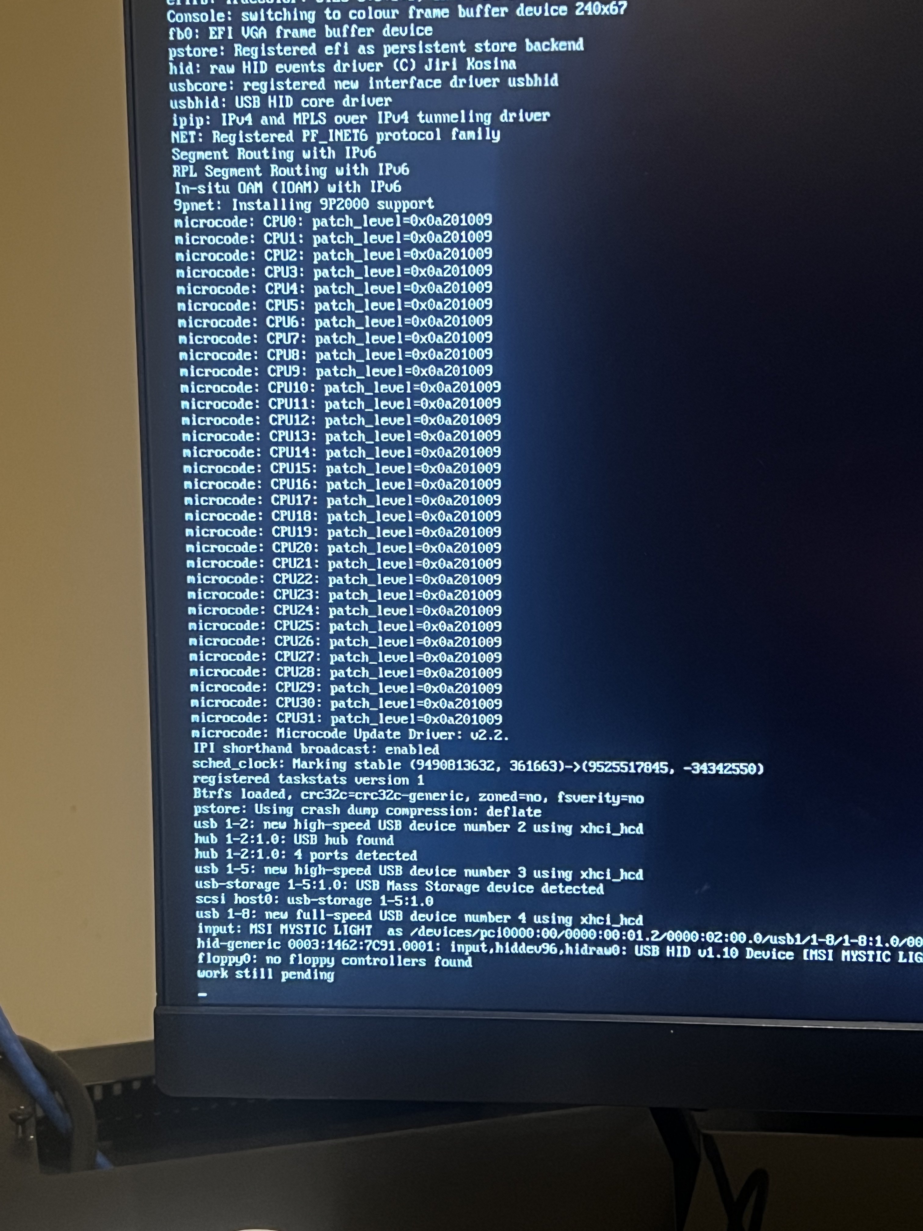

So I flashed another Philips drive (32GB) with 6.11.5.  Restart the machine.  Attached is where it stalls out.
"Work still pending"  ???
What does that even mean?

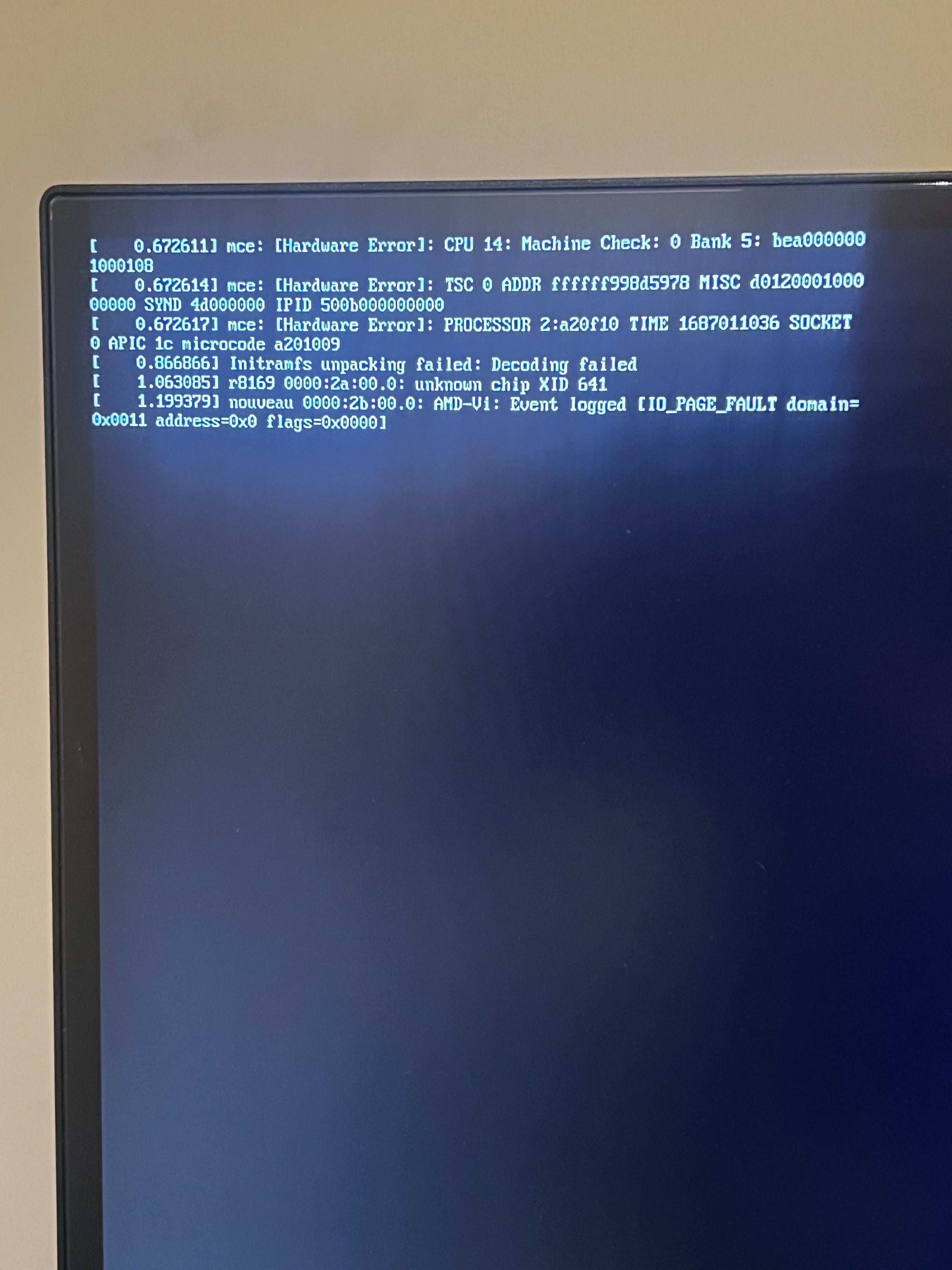

Booted from another USB into Ubuntu.  This is what I got:IMG_3396_1.thumb.JPG.552671773c85960c27a8f2d8ce67fe74.JPG
Is this an indicator my CPU is effed?
Where would you go from here?  Order another 5950X?
I dont use amd so not sure. maybe I would reseat memory and do a bios reset/update if there is one. maybe a mem test.
Looks like there's some hardware issue, what is more difficult to say, start with just one stick of RAM if you have multiple, but try more than one by itself in case the first one is bad.
