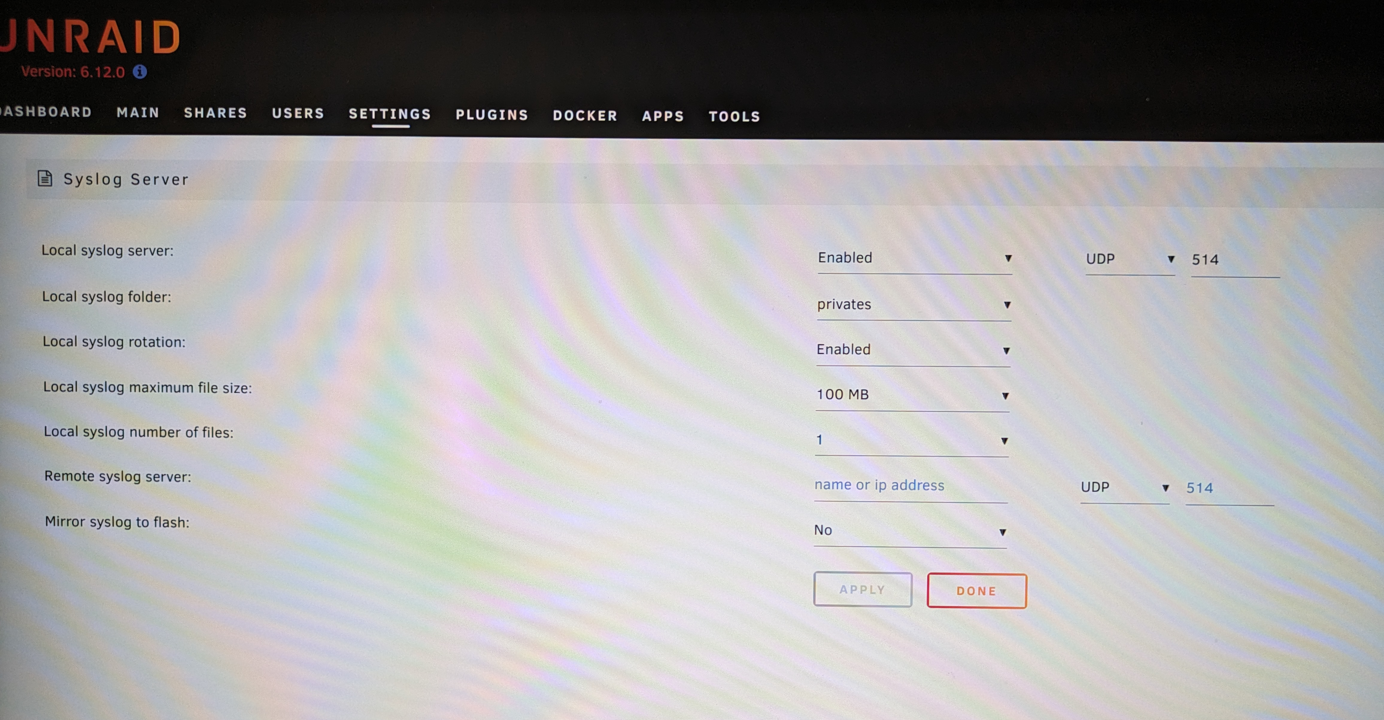

June 17, 20233 yr HI, I have since some month issues with Unraid, it's after 2/3 weeks not reachable, so I need to start it. I Downloaded the logfiles, but for me it looks like that it only have logs which are after the crash and reboot are availabel , so I can't see what happed. I'm not on new intel I have i5-9400 CPU so this should not be an issue. Please let me know what I can do to get logs with crertent information which I can pass to the forum here. Local syslog server is anebaled and set to 100 MB. But I can't see any logs on the location I set up. Thanks
June 17, 20233 yr Community Expert 24 minutes ago, derbe said: Local syslog server is anebale Post a screenshot of those settings.
June 18, 20233 yr Author I can post Diagnostic, but it only show any log after the crash. Not sure if this helps. tower-diagnostics-20230617-2014.zip
June 18, 20233 yr Community Expert 37 minutes ago, derbe said: I can post Diagnostic, but it only show any log after the crash. Not sure if this helps. tower-diagnostics-20230617-2014.zip 114.48 kB · 0 downloads these syslog server settings only set up the server to receive syslog entries from elsewhere. If you want entries from this server you either use the Mirror to Flash option (best and easiest) or put the IP address of this server into the Remote syslog server field.

July 23, 20233 yr Author Hi, Syslog Server is enabled, but in the folder where it should store there is no logs file(s). Edited July 23, 20233 yr by derbe
July 23, 20233 yr Community Expert Just now, derbe said: Hi, Syslog Server is enabled, but in the folder where it should store there is no logs file(s). Have you set either the mirror to flash option, or set the Unraid server’s IP address into the remote server address.
July 23, 20233 yr Community Expert 4 minutes ago, derbe said: Mirror syslog to flash is set to yes. Remote syslog server is empty. Then you should be getting a file created in the ‘logs’ folder on the flash drive.
July 23, 20233 yr Author Does this need to be on the stick? Cause now it points to folder on a drive which is mounted. Looks like there is only mounted folder shown. But for sure there is no log on the selected folder. Edited July 23, 20233 yr by derbe
July 23, 20233 yr Community Expert If you mirror to flash drive, that is on the boot flash drive in the logs folder. If you set it to log to a different path, you also have to tell it which server you want to log it to. 18 minutes ago, itimpi said: set the Unraid server’s IP address into the remote server address.
