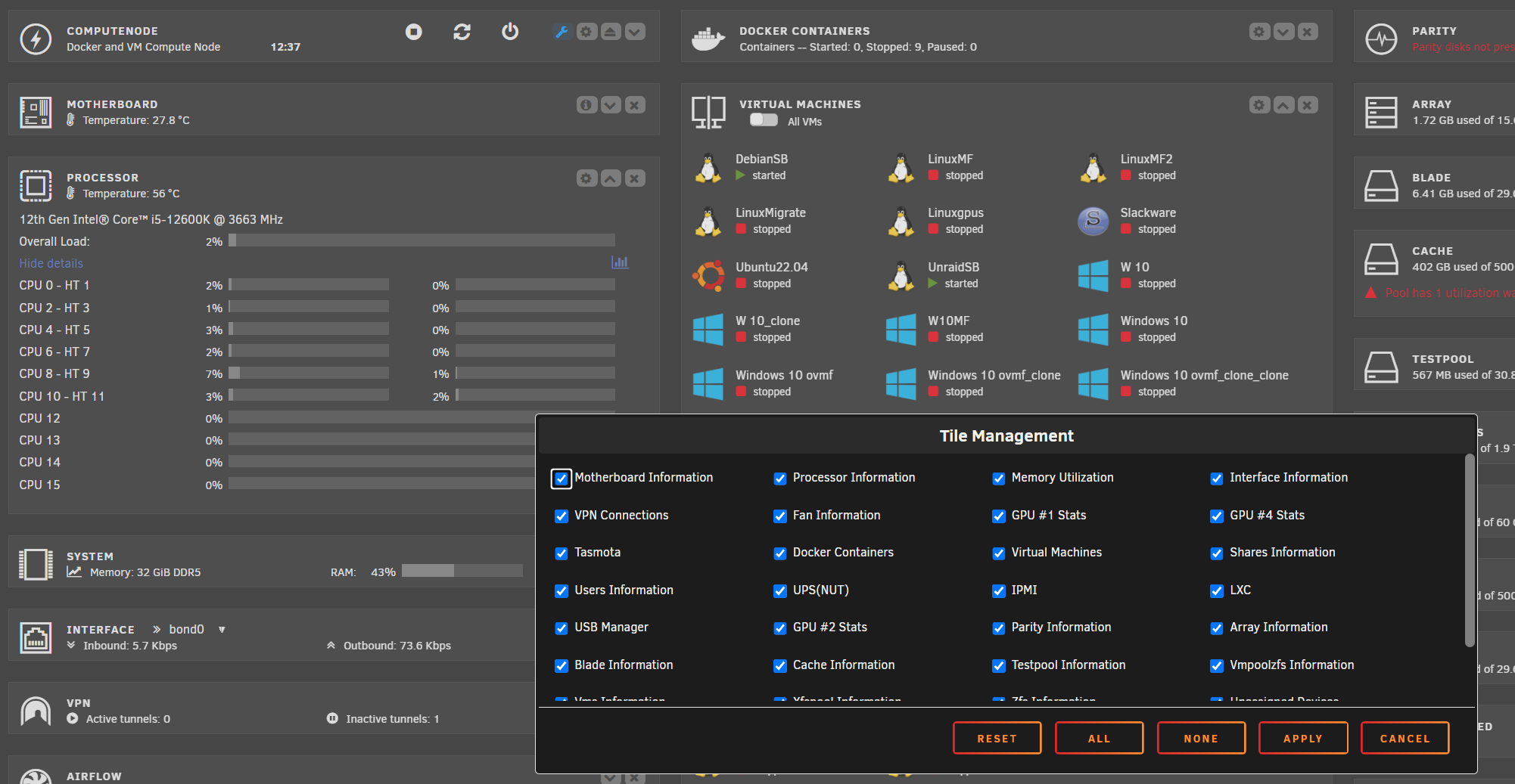

How do you open the Tile Manager? i do not see any Settings menu for it. Im running 6.12.4
Click on the padlock near top right and then a spanner should show on the main system tile top left.
Click on spanner and you will see the Tiles pop up.

Thank you
Resetting the Dashboard through Tile Manager still doesnt stop the Dashboard from resetting each time it is closed out.
