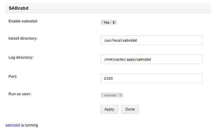

Screenshots:

Just pushed a new version of all three plugins.
Now the port can be configured for all three apps and the user select is somewhat nicer :)
also fixed a few little bugs

@benni-chan
i changed your Plugin for my needs. Now you can choose the Install and the Log directory.
Thanks again for your work.
spidi
