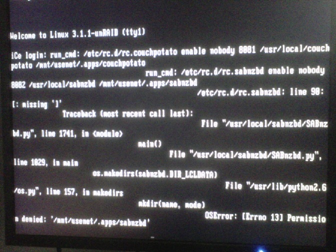

could someone help me get sab working on unraid.
i installed it no problems, but now i can't get it running on the server. I pretty much copied everything from page one on the web gui and this is what my server is reading out.
  • Replies 1.2k
  • Views 253.6k
Oh and my sickbeard is pretty much doing the same thing... in web gui it says sickbeard is running, but on the server after
run_cmd: /etc/rc.d/rc.sickbeard enable nobody 8083 /usr/local/sickbeard /mnt/usenet/.apps/sickbeard
it says
/etc/rc.d/rc.sickbeard:line 78 [: missing '['
                                                              Unable to create datadir '/mnt/usenet/.apps/sickbeard'
Please help :) thnx
Looks like either the directories do not exist or sab and sickbeard do not have permission to access them.
Run these:
mkdir /mnt/usenet/.apps/sickbeard
mkdir /mnt/usenet/.apps/sabnzbd
chown -R nobody:users /mnt/usenet/.apps/
chmod -R 774 /mnt/usenet/.apps/
This will create both directories, make nobody:users the owner(what sab and sickbeard are set to run as) and give the user "nobody" read/write/execute permission as well as anyone in the group "users", and give everyone else read access.
This ensures that sab and sickbeard can write to the directories and you will be able to as well if you need to from the user share.
Also a note, unless you specifically want it that way, since your data directory isn't on the cache drive, you don't have to have the "apps" folder hidden(putting a period at the beginning of the name). This is used on the cache drive to stop the mover script from moving the folder.
