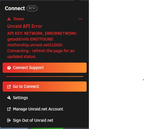

API KEY: NETWORK_ERRORNETWORK: Unable to connect to https://mothership.unraid.netCLOUD: Connecting - refresh the page for an updated status.
After I updated to 6.12, it appeared “API KEY: NETWORK_ERRORNETWORK: Unable to connect to https://mothership.unraid.netCLOUD: Connecting - refresh the page for an updated status.”

yes same for me .
Tryed to replace DNS config and downgrade to last version but no success yet.

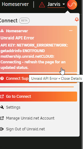

Same error her ,  -BUT FIXWS NOW
Version: 6.12.0
I found out taht my server don´t get an gateway, but all my other device do
I have set the unriad server up with static IP gateway and DNS now, that was my fix
And then logged my server off the mothership and back on now it works
Edited by Jarvis
The ntp problem has been solved
