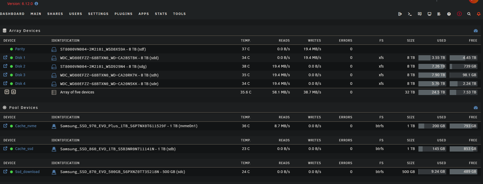

so i updated unraid to 6.12 for 6.11.5, and i'm trying to move everything from my pools to the array to format the pools to zfs.
the problem is the mover is REALLY slow, i change the write method to reconstruct write , but it didn't make any difference.
as you can see in the picture the speed is 19.4 mb/s but the problem is it stays like this for a second and then go to zero for a couple of second and be something between 2 mb/s and 22mb/s for a second and go back to zero again.
is this normal?
i recall when moving 400 gigs from the download ssd it didn't take too long to do it maybe an hour or 2 max. now i've been running mover for almost 3 hours and it only moved around 50-70 gigs
i disabled docker and vm so the mover doesn't run into problems when moving the appdata
tower-diagnostics-20230620-0702.zip
Edited by sohailoo
Solved by itimpi
If you are moving lots of small files (as if often the case for the appdata share)  then mover will be slow as there is a significant overhead per file for checks that mover does before it moves a file.  It can be faster to use something like Dynamix File Manager to move the shares from the cache to a specific disk,

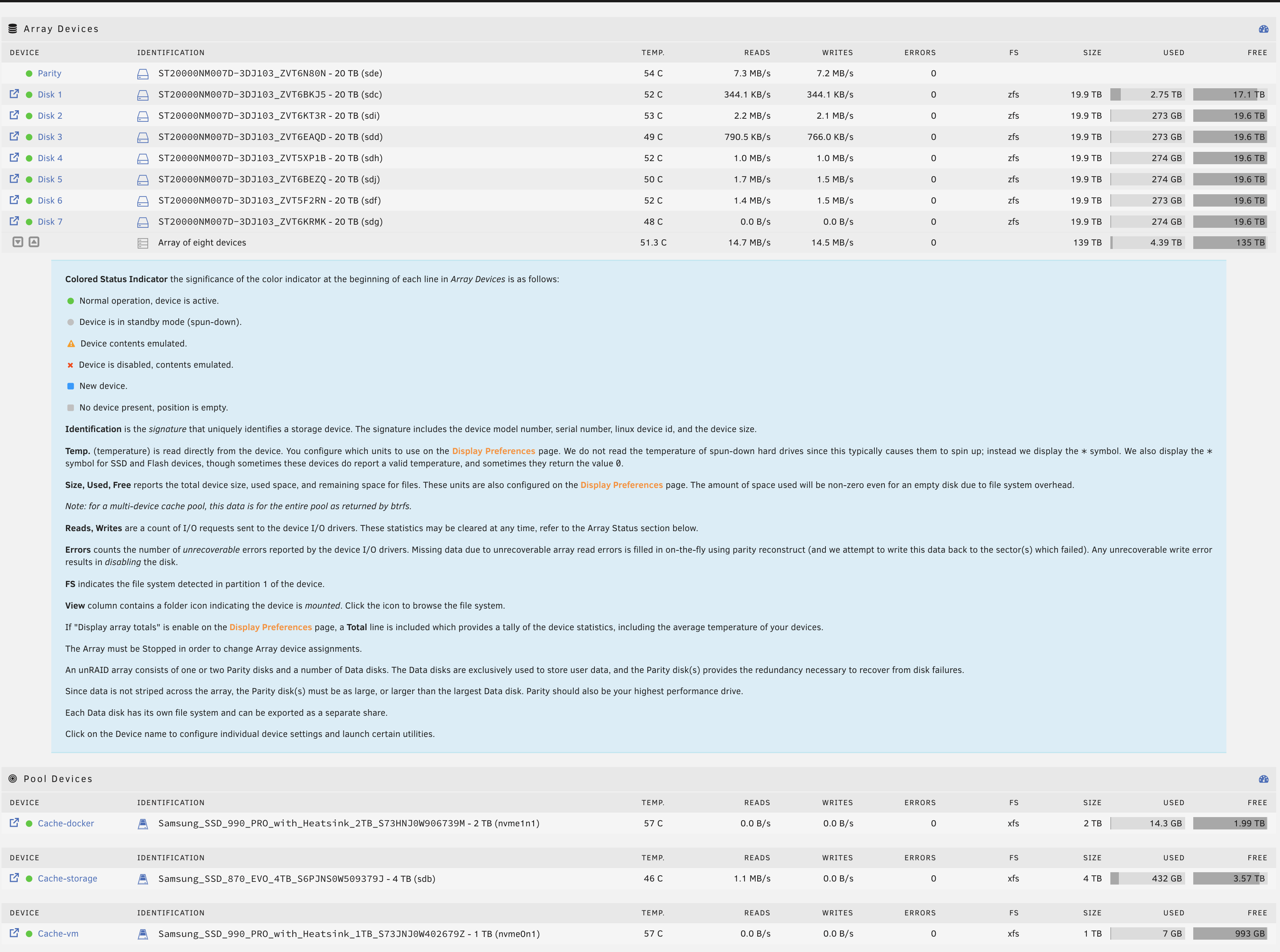

I'm having the same problem with the mover being too slow.  This is my first time setting up unraid as a server and I'm in the middle of copying files over.  With the SSD as a buffer to the Array, I'm getting maybe 1 to 5 MB/s in through put.  The system is currently just running mover.  The SSD cache (`cache-storage`) only has 400 MB sized files in there.  I'm transferring a bunch of videos atm.  So these aren't small by any means.
727864702_Screenshot2023-11-06at1_29_41PM.thumb.png.122149d7f6efac1b773e13922a600984.pngunraid-diagnostics-20231106-1330.zip
Looks like you are using the most free allocation method, that is much slower than the other ones since parity writes will overlap.
