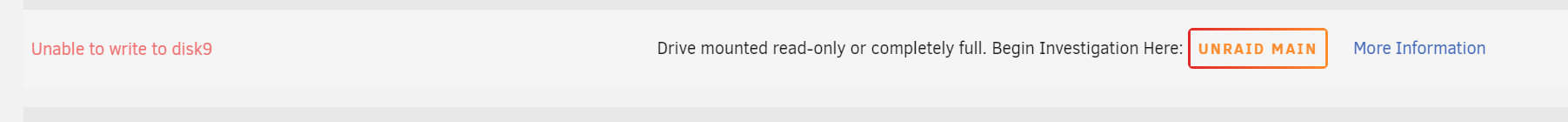

Thanks. I noticed the free space was ~5GB for disk9. After a rebooy and the free space went back to ~60GB.
There is a warning from Fix Common Problem.

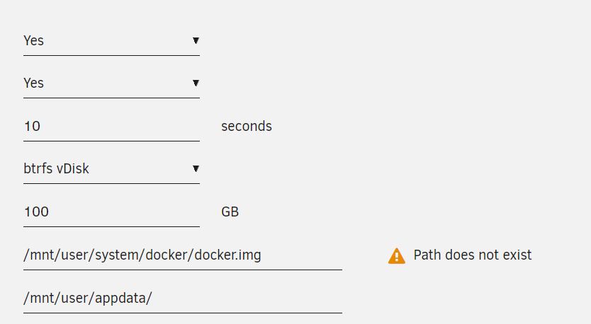

I think the disk9 is too full to copy the files. So the parity sync failed. And now docker doesn't work as the path of the docker folder doesn't exist anymore
