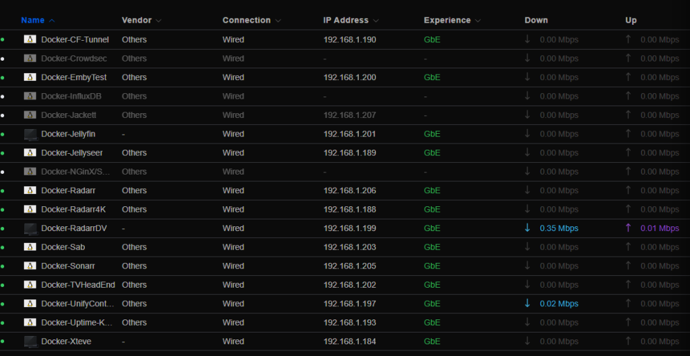

From what I have read, the ubiquiti unifi controller does not like all the machine switching caused by ipvlan due to the shared mac address for all the containers.  I have 17 containers, and the unify software shows me the real time upload/download of each, but as it is by mac address, this is not possible if I change to ipvlan - Personally, I have no issues with macvlan - never had a kernel panic or a failure to date, but I worry about upgrading from 6.11.5 and introducting these issue, forcing me to change and losing the below :
