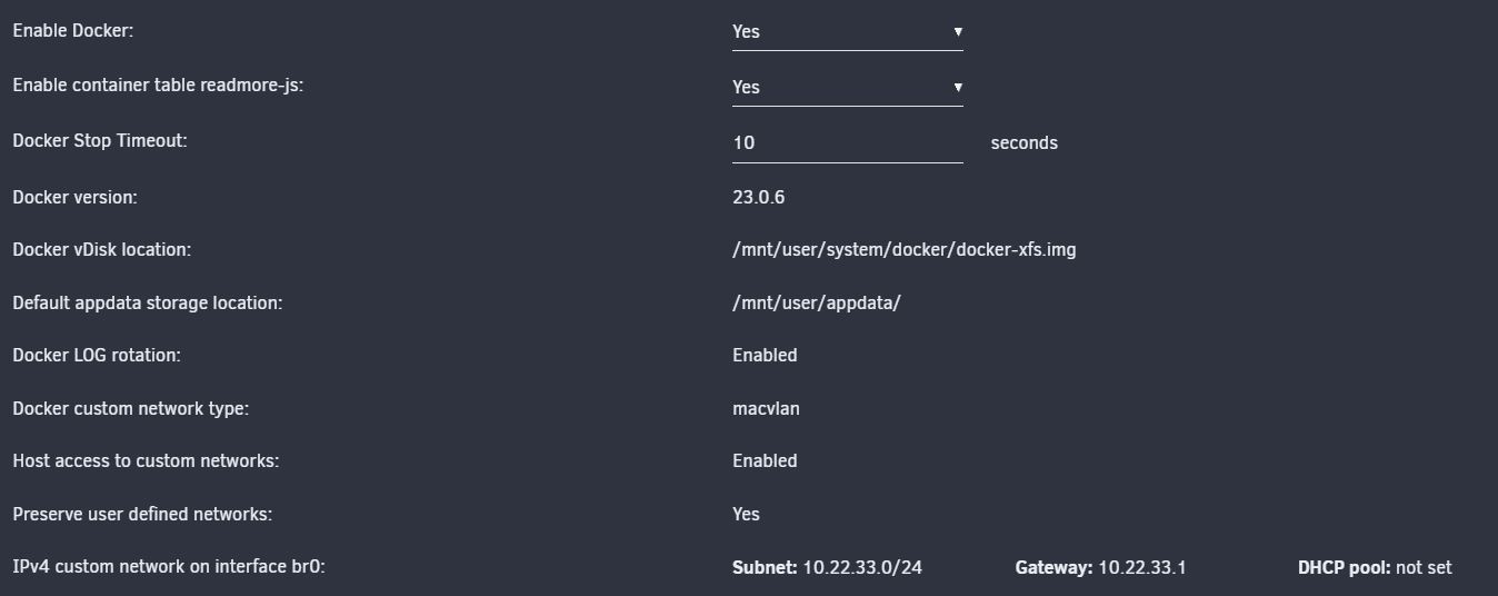

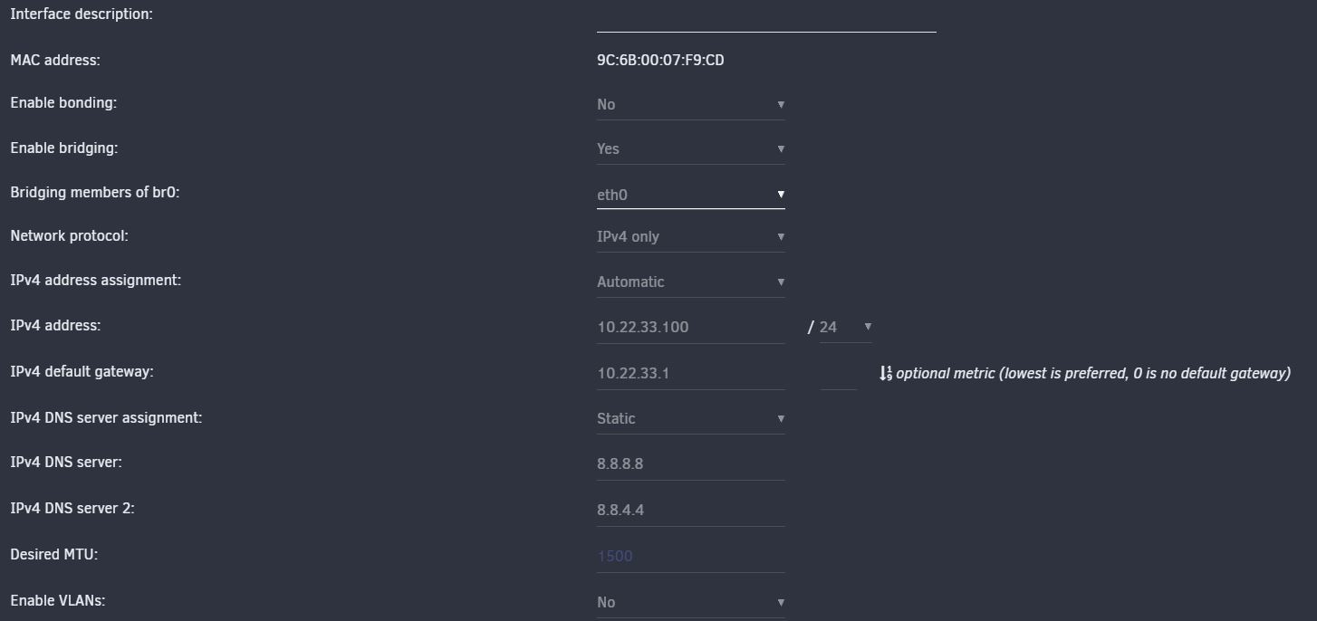

June 23, 20233 yr Hi all, recently I noticed my docker containers weren't auto-starting. I figured it might be a glitch in the 6.12.0 RCs, and didn't think much about it. But yesterday I noticed that my PiHole containers aren't starting even after I click "start all". Digging a little more, I found that they had lost their IP addresses, and that br0 wasn't listed in the available networks: I tried rebooting, and also following the docker network rebuild instructions in this thread, but neither helped. I'll attach my system diagnostics. I'll also attach my docker and network settings. Any help would be appreciated. Things I've done recently: installed various 6.12.0 RCs, installed a gluetun container to experiment with (which created a proxynet I think), booted the computer with the network cable unplugged. storage-diagnostics-20230623-0849.zip Edited June 24, 20233 yr by coppit Marked solved, added 6.12.0 to title
June 23, 20233 yr Community Expert Solution br0 is up: br0: flags=4163<UP,BROADCAST,RUNNING,MULTICAST> mtu 1500 inet 10.22.33.100 netmask 255.255.255.0 broadcast 10.22.33.255 Start by updating to v6.12.1 stable.

December 19, 20232 yr Community Expert Try disabling and re-enabling bridging, if it doesn't help post the diagnostics.
