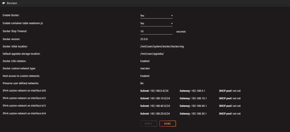

how do you get custom br2 br3 etc to show up in docker?
there seems to be something wrong with my unraid i posted an issue no one has replied to about  parent br  br2 br3   and i trying to reinstall shinbo  to try this program out  but i find  there is only custom br0    not br0 to br5   whats causing this issue?
i get this error no one has figured out
Jun 24 19:36:42 Tardis root: Error response from daemon: network dm-b6e310e46181 is already using parent interface br2
Jun 24 19:36:42 Tardis root: Error response from daemon: network dm-27db50de59ed is already using parent interface br3
Jun 24 19:36:42 Tardis root: Error response from daemon: network dm-384eab18d937 is already using parent interface br4
so in dockers  all i have is none,bridge,host, custom:br0     i dont get my other brs..
i tried deleting the network.cfg to try to fix it but it didnt help
what can i do to fix this error and what not and get the customs  br's back

I'm not sure what you are asking but I'm curious what these say:
ip a |grep " br[0-9]:"
docker network ls
It looks like the networks already exist at the time the custom networks are created, giving a conflict.
Try the following
- Stop all containers
- Open a terminal window
- Execute:
docker system prune -a
- Restart the docker service
