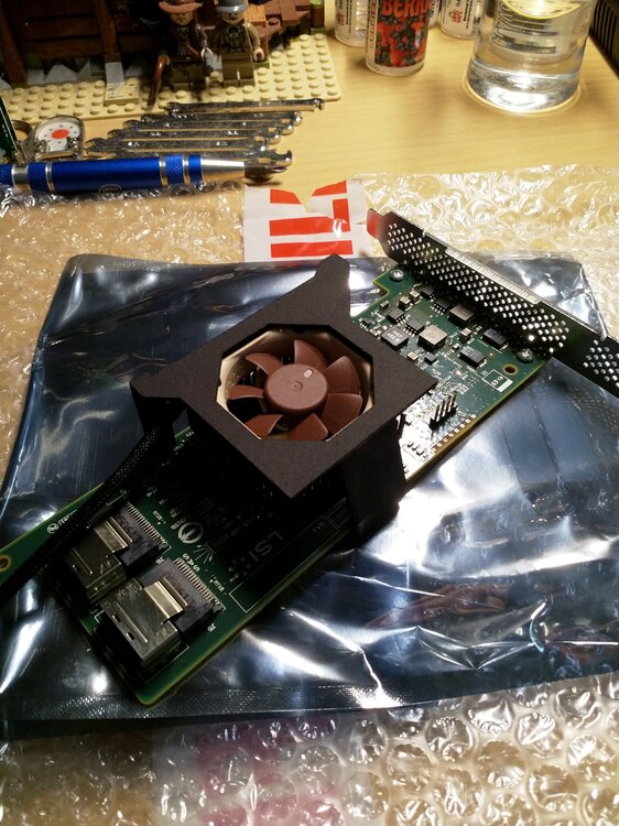

PSA for people with HBA's... Attach a Noctua 40mm fan directly to the heatsink.
100% or if like me you cant fit it directly then have a 120mm or 140mm fan directly above it blowing directly at the HBA.

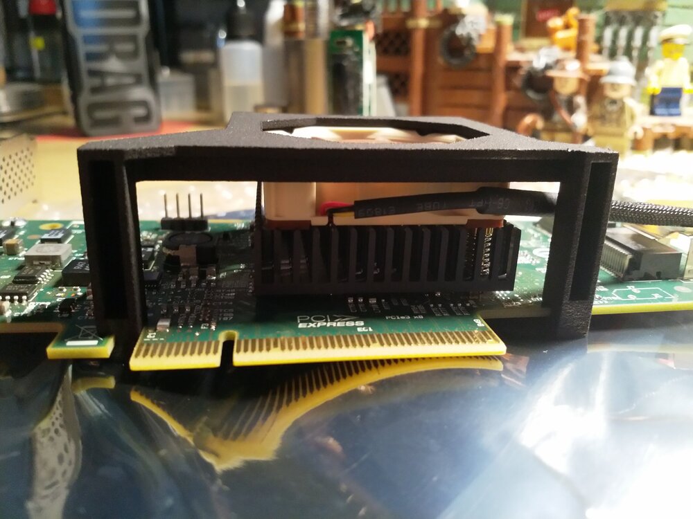

Those HBAs can get surprisingly hot, especially in low airflow cases. A small Noctua fan is quiet and makes a noticeable difference in temps and stability.
This type af HBA "need an active airflow" - otherwise, it gets more then 60°C
