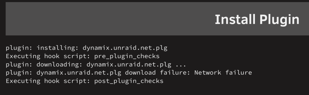

When trying to update (or install) plugins, I am getting: "Checking connectivity ... No response, aborting!"
When trying to update the OS, I am getting (when checking for updates): "plugin: checking unRAIDServer.plg ... plugin: checking finished."
I am out of ideas!
Quick update:
I upgraded my unRaid server to v6.12.3, using the manual method described here.
Again, no luck in resolving the issue "download failure: Network failure".
Any suggestions are welcome!

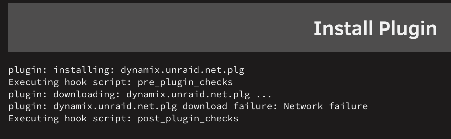

I had tried with and without IPv6, but it made no difference.
I tried again as per your suggestion, rebooted, and tested with a plugin install, but again no luck (see screenshot attached).
I have attached a new diagnostics file.
unraid-diagnostics-20230719-1444.zip

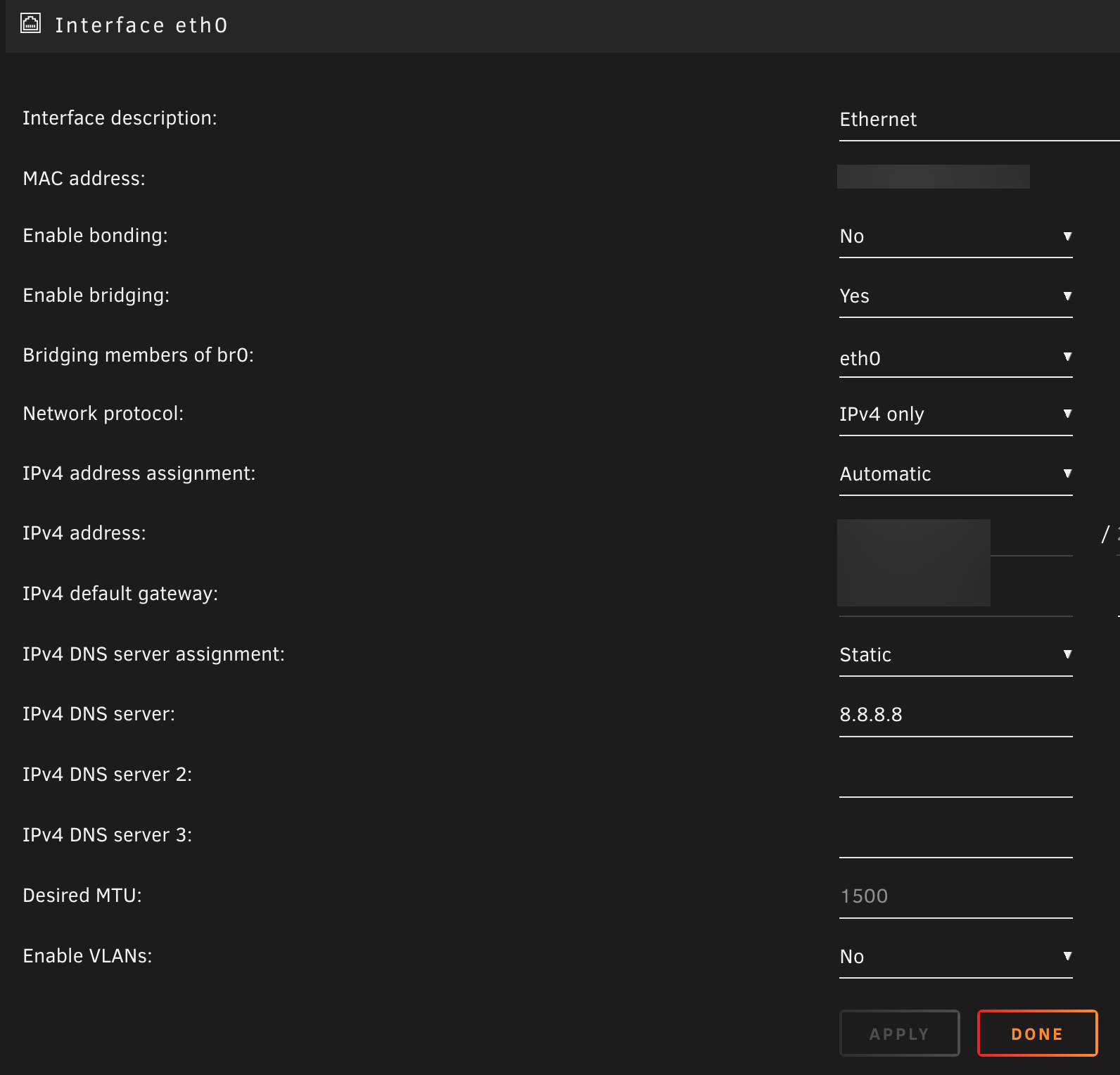

So the system must be on the network since you can access its webgui. Since it can't connect to the Internet that sounds like either a bad gateway or DNS server.
Go to Settings -> Network Settings and see if statically setting the DNS server to 8.8.8.8 helps.
Success!!
I had previously tried 8.8.8.8, but as DNS server 2, not primary.
With the setting in the screenshot attached, problem seems solved.
I'll do some more test, but looking good.
Thank you ! 👏
