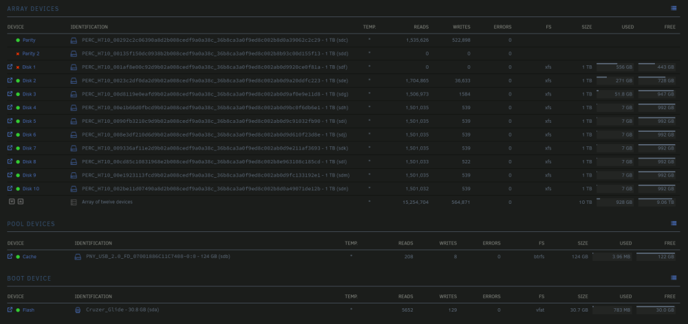

Jellyman261 Posted June 25, 2023 Share Posted June 25, 2023 Sorry in advance am very green when it comes to server terminology.  I updated my Unraid server (don't remember the version I started at) to Version: 6.12.0. After the reboot for the update, I received an alert about my second parity disk and disk # 1 was disabled. I think all I need to do is rebuild, which I was hoping someone could walk me through it. jellystorage-diagnostics-20230625-1509.zip Quote Link to comment

JorgeB Posted June 26, 2023 Share Posted June 26, 2023 Due to the RAID controller cannot see SMART for the drives, emulated disk is mounting so you could try rebuilding, though it would be better to replace that RAID controller with a recommended model first. Quote Link to comment
