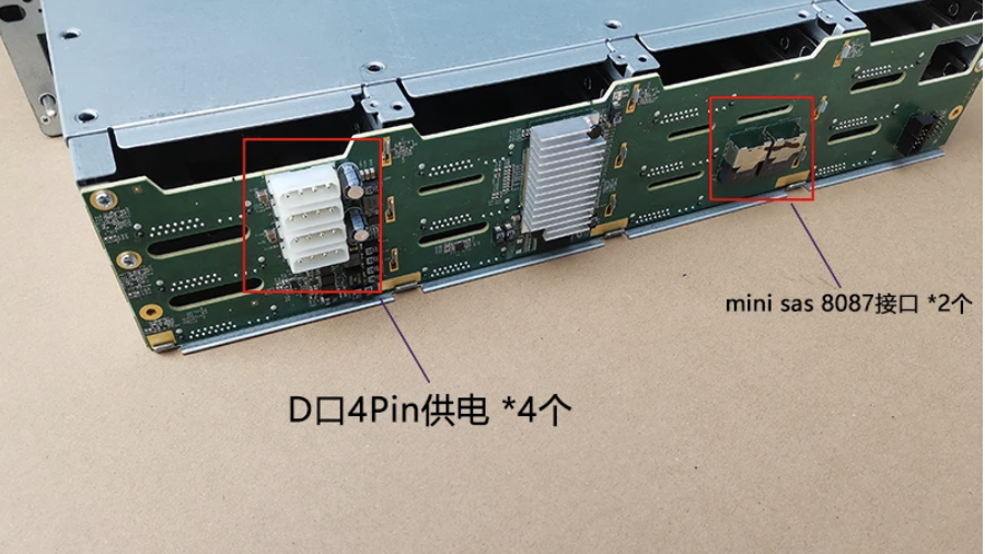

So I've got 2x of these 16x bay expanders on the way..
I only need 1 working to start with.
Each takes 4x molex.

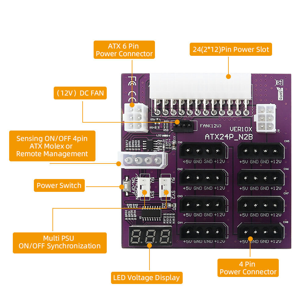

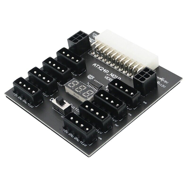

My question is has anyone used one of these ATX adapters?
Takes the unused motherboard feed and splits it up.
Ideally I'd want it to power up with the server... so would I just run the 2 cables over to the other PSU?
Not sure how the built in switch here effects my idea but I could probably desolder it if needed.
Those adapter should be for PSU fan-out to 8 molex ( from 24 pin + 6 pin gpu ) and the switch is control PSU on / off. It is not for connect to motherboard.
https://www.amazon.com/dp/B09PRFYX9P
If you need sync server side on/off, you need below version.
