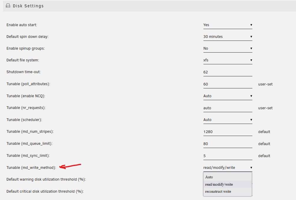

July 5, 20233 yr Community Expert Are you writing to array or cache? If array is turbo write enabled?
July 5, 20233 yr Author 33 minutes ago, JorgeB said: Are you writing to array or cache? If array is turbo write enabled? i am writting to array, cache disk is not installed in my server, i want to install that, but dont know which size disk i should install for cache, and please tell me how to check turbo write isenabled or not ?

July 5, 20233 yr Author 2 hours ago, JorgeB said: thanks for your reply, please also tell me how to install this turbo write in my NAS, its a plugin??
July 5, 20233 yr Community Expert 20 minutes ago, Snooky said: thanks for your reply, please also tell me how to install this turbo write in my NAS, its a plugin?? Go to Settings >>> Disk settings and see this:
